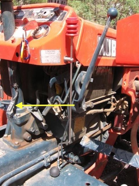

Don't know much about the BX, but I added a long pigtail to my B7100 battery tender hook up & zipped it to the steering column. Handy, yet out of the way.

Lil foot
That is a nice parking brake aragment you have there. I think I am going to copy that if you don't mind.
