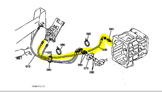

At some point in time the previous owner had the mid mount mowing deck removed due to bearing failures. He replaced it with a 3 point hitch drag along mower. A rear mower won't work for me.
I plan to get a mid mount mower before spring and mount it myself. Many of the original attachments are still on the tractor.
The problem is that sometime after the mower was removed, someone rerouted a hydraulic line from the FEL control box to the HST by just tying it up underneath the tractor. I don't know for sure but it looks like this will interfere with the installation and operation of a mid mount mower.
Is there some place to look for drawings or photos of where the line is typically run to keep it up out of the way of a mower?
I can improvise but would prefer to follow the original route of the pressure line.
Would someone with a B7300 or similar tractor be willing to take a few phone pics of the route of the line for me?
Pics of the line I want to change attached.
