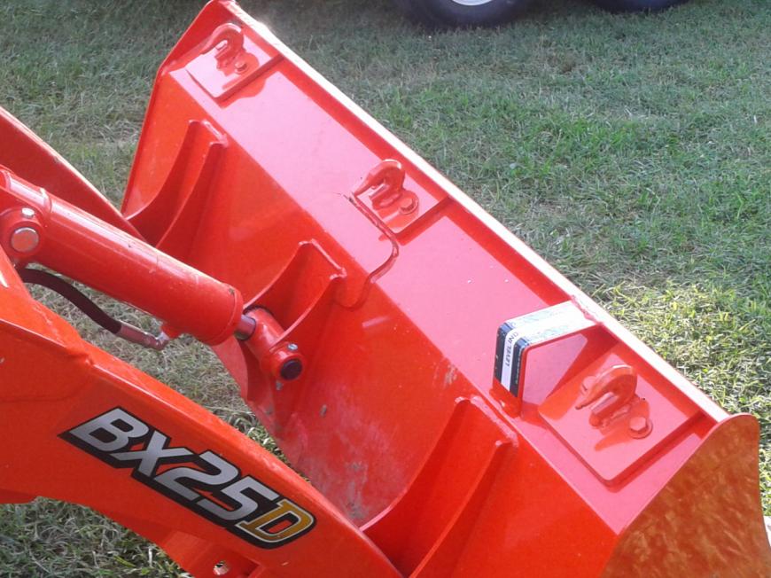

Was going to weld some hooks on my bucket. Do I need to disconnect my battery......or remove the bucket from the FEL? Didnt know if there were any electronics that could be potentially damaged. Thx

It took me all of a minute or so to drop the bucket off my FEL when I welded my hooks on. It may not have been necessary but it was worth the piece of mind to me that I wouldn't have any problems. If you don't want to drop the bucket then I would suggest at least disconnecting the battery. That should isolate you electrical system. Also keep your ground clamp as close to where you are welding as you can.

It is ok to weld. I have welded hooks to the FEL and repaired the stairs on my backhoe while it was attached to the subframe...
I did grind a nice clean ground contact spot for the welder to clamp to (used a magnetic ground attachment on my welder), that was also close to my work area...no problems...

Also consider NOT welding to the bucket and welding to a plate THEN bolting to the bucket via grade 8 bolts - true might cost a little more - and a couple of holes in the bucket - but if you ever want to change something, better to unbolt than to grid off. Plus the plate places a larger footprint across the bucket.
