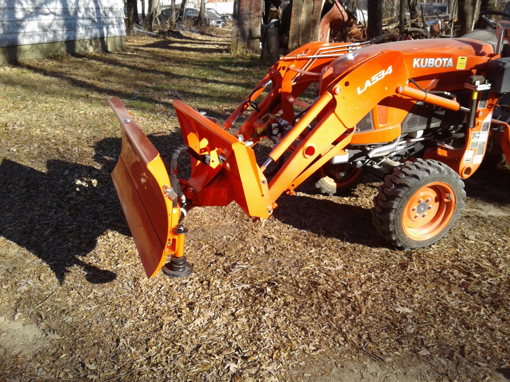

Something just crossed my mind last evening. Now the BX has the whole quick hitch for the blade, and the comming B, has a FEL and bucket and no blade. I am wondering if the quick hitch for the BX would hook up under the B so I could use the plow with out having to re-engineer the whole thing. Im sure with copious amounts of welding rods, wire, and steel plate it could be done. I just wondered if any one ever did it?

Skeets- seems like the front hitch for the B is much different than the BX...much longer, part of which seems like for the bearings for the PTO.
Now you don’t need the mid-PTO shaft to use the blade.....
It seems like the mount for both is similar with the wedge-type blocks, if I remember right. Might be worth just lining up the hitch the tractor to see what it looks like.

SSQA blade for "B" uses oddball angle cylinder.

I used a friend’s SSQA plow to do his driveway when he was laid up.
Wasn’t a power angle, but worked good

A hitch for a B is a LOT bigger and heavier built than on for a BX. They also cost a LOT more money. My snow blower came off of a B model and I thought about cutting it down to use it on my BX, but I found a new/ used blade and it had the correct hitch for my tractor. I sold the B hitch on this site a couple years ago. Keep an eye out in the ads on this site. You may find just what you need.
