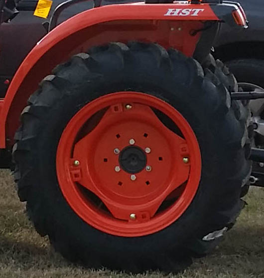

6. I want to move my rear wheels out to the widest setting since our land is mostly on slope. It looks to me like I can lift the rear of the tractor and swap the wheels from one side to the other, putting the part that is currently facing out to the inside of the opposite side. Is that all there is to it? Will a floor jack and jack stands get the job done?
#1 a very solid and stable jack and jack stand surface!
What weight rating are the jack stands and Jack? make sure they rate out to more than what the total tractor weighs to be safe.
The tractor pivots side to side on the front axle so be aware of that.
It's a long way down for your tractor to fall with the back wheels off so take it slow.
Break all the bolts loose before lifting, lift the whole rear off the ground about 1/8 to 1/4 as lifting those big tires a bigger distance is impossible without help, a cherry picker (engine lift) is a huge help, have help unless your big, and keep critters and little ones completely out of the way!
If the tires are loaded with ballast they are going to be extremely heavy and awkward to move.
You are a brave man. I'd check with the dealer first. My rims are not reversible but, even if they were, being water filled they weigh something like 350lbs apiece! Be very careful!!

I did mine on my L3940 a few weeks ago.
Mine came apart easily, so I expect yours would too. A few whacks with a deadblow, and they loosened right up. If not, loosen the bolts, sit it down, and drive forward/backward a tire rotation.
Anyway, I had one friend/neighbor help me. We did a lot of up/down jockeying, but it wasn't bad. I think it took 2 hours. Mine have rimguard in them. I hate to know what they weigh, we were careful to keep them upright.
Cool! This gives me more confidence. Thanks for the pic!
My wheels are a little different with the R1 tires but I think the concept is still the same. I need to attach to the outer most tabs you see on the outside of the rim by moving the wheel to the opposite side and putting the currently facing outside to the inside.
Thanks again to everyone for all the help.

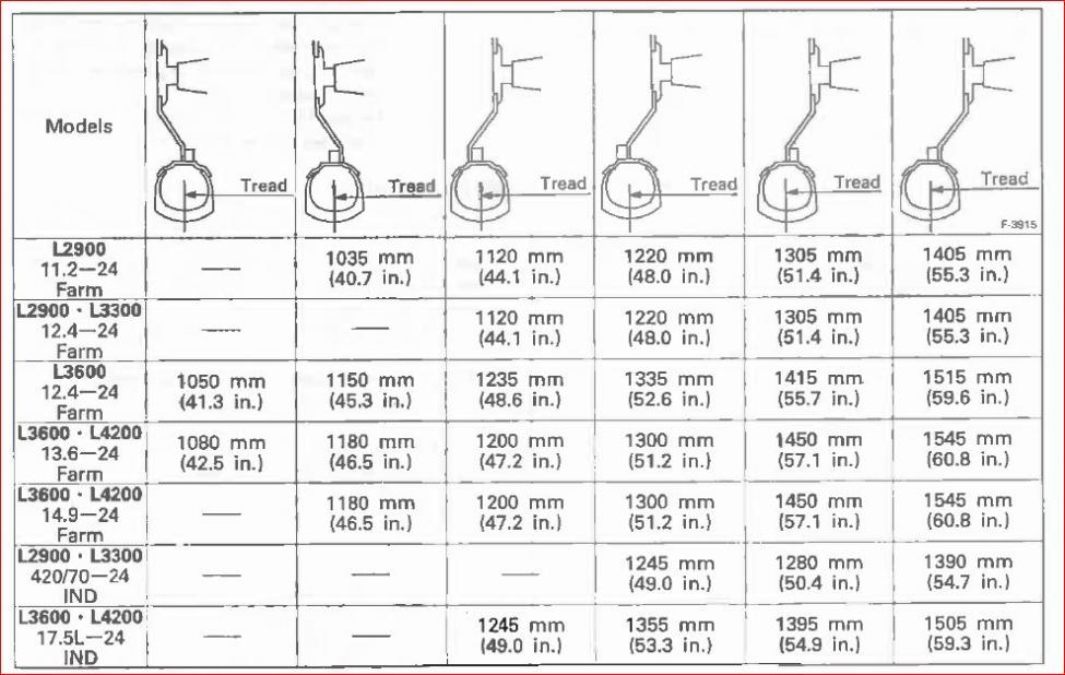

That style of rim with a dished rim center and outer rim ring can be set to several different widths, all the way from very narrow to very wide, and in some cases there is no need to change rims from side to side.
While this chart is not for your exact model so width of yours can vary, but it's similar in rim set up.
Thank you very much for this. My manual has a similar diagram, but the one you posted makes more sense to me. My wheels look like they are currently set at the middle position, or 47.1". According to my manual, I only have three positions the rims can be set to.
The FEL manual states that the rear wheels should be set to a width of 43.9" or more. I am OK with my current setting of 47.1" but would like to max it out at 50.8" for the added stability.
Is there anything to be concerned about when considering setting the wheel width to max? All of my implements are 5’ or wider.
No not really the rear axle setup can handle the wheels out as far as you can get them, they could even handle spacers and dual wheels if you wanted to go that route. :D
