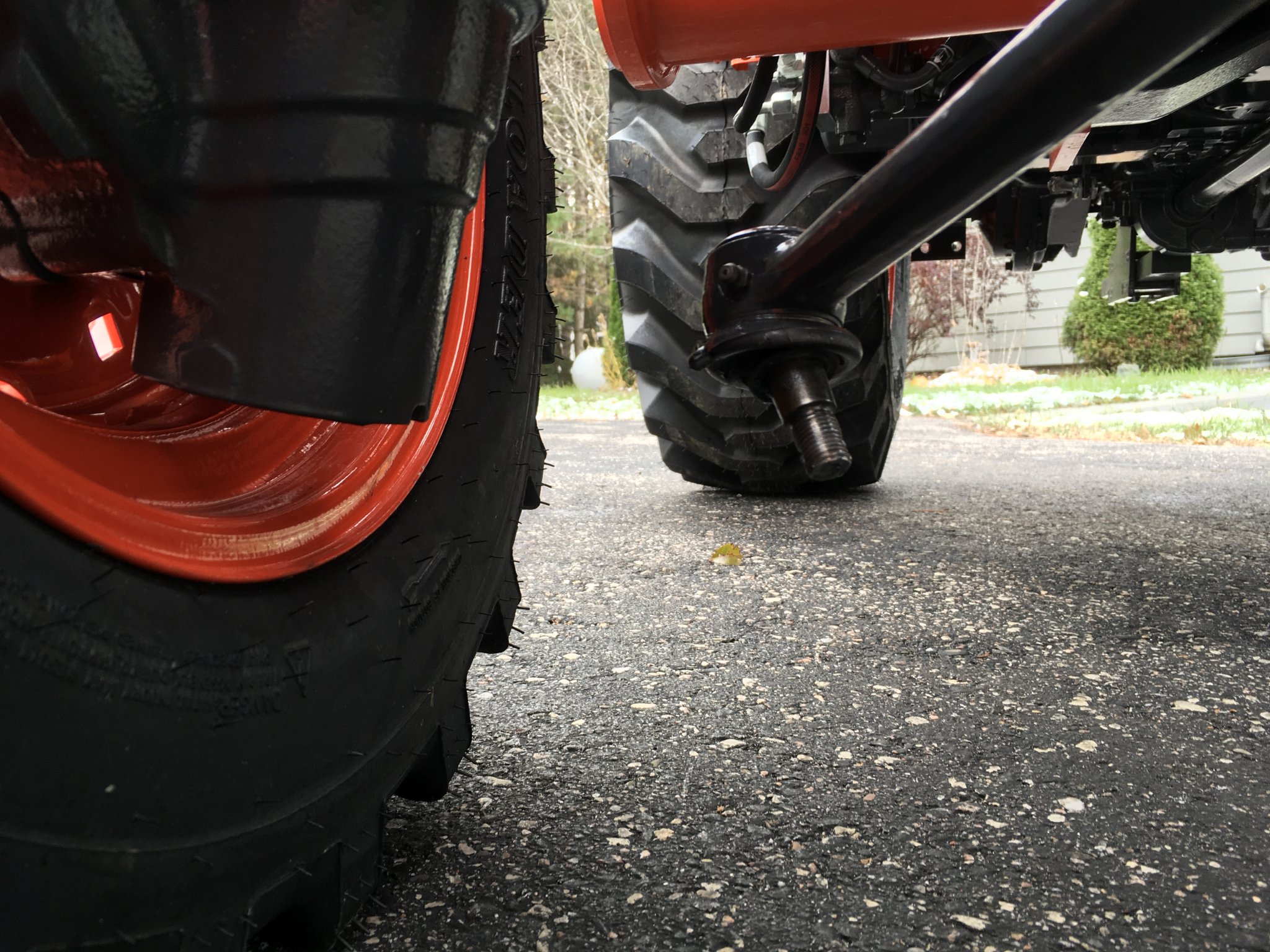

Besides the front axle being low on fluid also check the right front tie rod end. This is part of the dealer set up and mine was missed and at least one other user on the forum had a similar issue. When the dealer tech came to my house to fix he discovered the toe-in was not set correctly either. On top of that , not a single grease zirk for the tie rod ends had seen grease.
