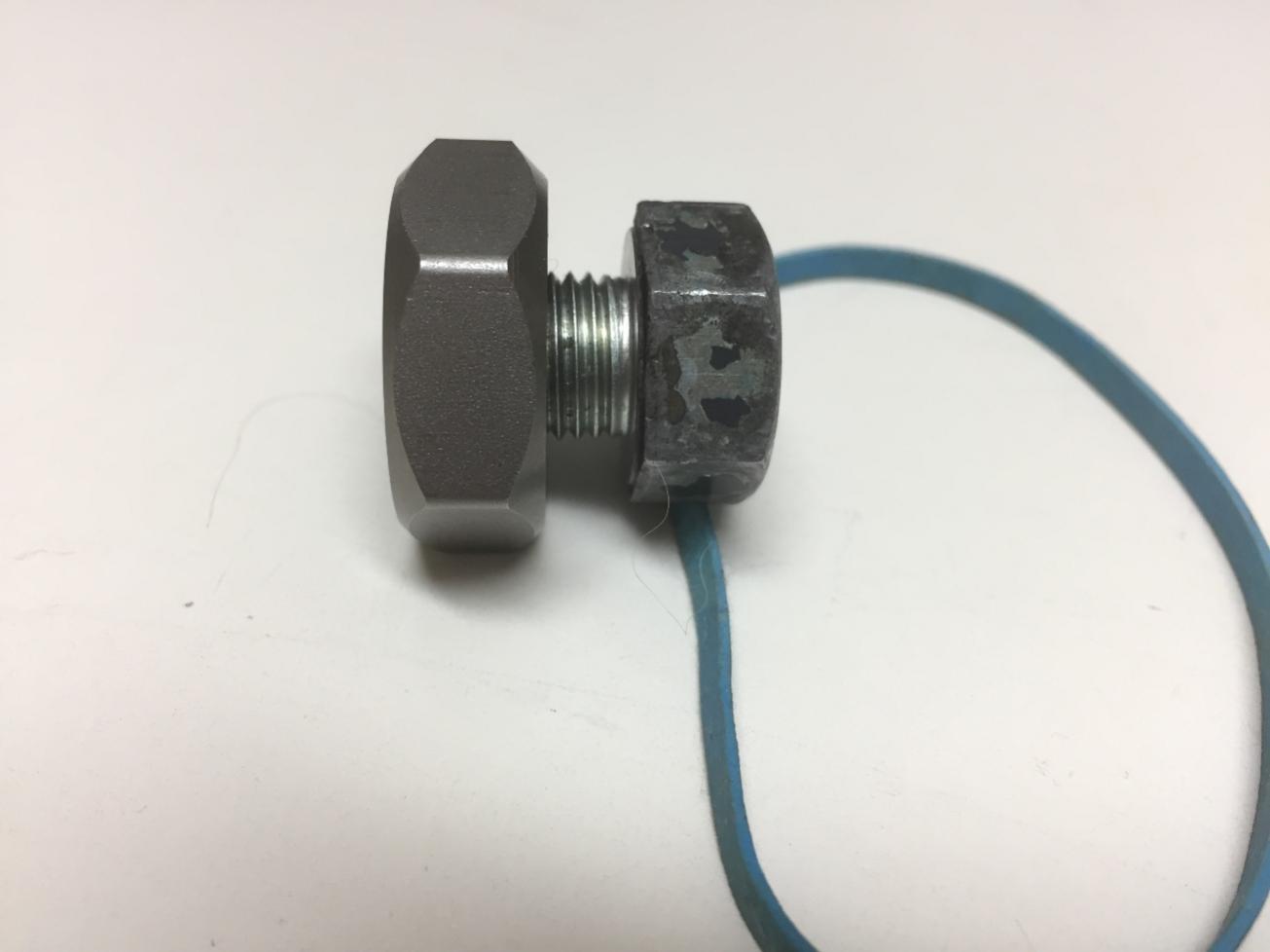

Interesting... I intended to tap the pan tomorrow after running a magnet round the hole. But for whatever reason I took the die out of the package and since I had the drain plug in my hand I screwed the plug into the die. What a surprise when I found it went in nicely for a half inch or so and then bound up. Just like what it does in the pan, (meaning roughly the same number of threads showing when the plug binds up in the pan).
I've never seen a drain plug "stretched" but that fits my symptoms exactly. The new plug won't be here until next week but in the mean time I'll fish for metal fragments and gently run the tap into the hole. I hope it will go smoothly since it seems the plug is the problem.

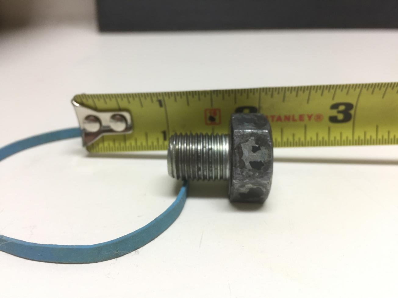

Pics attached. The plug is about 15/16 in long; the threaded portion is about 5/8 in. The picture with the plug screwed into the die shows about how far in it is when the threads start to bind up

I loaded the tap up with carriage grease and gently started it into the pan hole. After a few tries it caught and started in. It started to bind up after a few revolutions. By hand I gently advanced it a 1/8 turn, backed it off, and continued until it became easy to turn. I never had to put much strength to it, ( rotated the tap by hand with a short T handle) making me wonder if the threads were clogged up rather than stripped.
I examined the tap and grease for metal fragments and found none. I measured the point I stopped and then checked the tap after I pulled it out. I had screwed it into the pan 1/2 inch.
I put a handle on the die and a socket on the drain plug and worked it through the die to the base. It took a little more pressure than the pan but I can't say it felt like I was cutting new thread. I did have some metal fragments left in the die when I was done. Not a lot but some.
I then tried the plug in the pan and it ran all the way in by hand with little or no effort. I did not try to tighten it up against the pan. It screwed out just as easily as it went in. One spot gave me some slight resistance but I was able to unscrew it without using a tool.

Finally got the replacement drain plug. It's different in that at the base of the thread, the shaft tapers out. I noticed the oil pan had a slight taper in where the thread starts but didn't think much about it. Now I wonder if someone lost the original drain plug and stuck that flat plug in. It probably leaked and so they put a little extra effort into tightening it up.
That might explain the leaking pan, the stretched threads and the difference in the new plug. I'm done for the night so that will be tomorrows work.
