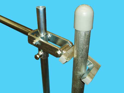

I'm frequently finding myself needing to pull various objects from the ground. Currently a number of chain link fencing posts cut beneath ground level by some sinister fiend. I've resorted to drilling holes and inserting bolts through as a means of providing purchase to loop my chain around to pull them, but this is time consuming and enraging. Does anyone know of the proper or common nomenclature for such a device used for lifting/pulling that converts, by means of a scissoring action, the pulling force to exert pinching/gripping force?? I can only assume there is a variety of types and sizes for various industries and applications, but I can't begin to think what to search for... Gold star and eternal gratitude to anyone who can put a name to this thing and make my life a little easier...

For the chain link post, I wonder if a beam clamp or two would work to keep the chain from slipping, with no drilling needed.

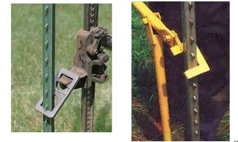

If you have enough post to grab, and don't mind denting it, a plate or hook puller will work, too. You can use a tractor to lift it, instead of the jack or lever shown. A round hole or hook shape will probably work better on a round post.

Brush grubber mini,sold at menards,scissor type,larger sizes probably available

Some version of this may help. https://www.tractorsupply.com/tsc/p...MIjPKCkYvq3AIVBbXACh0F7A7zEAQYBCABEgK6V_D_BwE

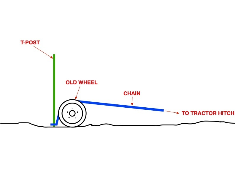

I'd suggest you dig down around the concrete a few inches with a shovel (backhoe if you have one) then loop a chain around the concrete as tight as possible. Now take a steel wheel (like from a vehicle, larger is better) and loop the chain over the wheel as the wheel sets right next to the concrete. Now hook the long end of the chain to the ball on your pickup or tractor and pull. The wheel will provide the lift needed to get it coming up and out.
Like this:

Very clever. Banking this for future use. Thanks guys!
I don't use the wheel trick often, but I try to save up several jobs ( pulling T-posts, saplings, small stumps, etc) and do them all at once. Saves having to drag out that rim & big chain several times.
I use a 15"x 12" wide car rim, works well. The guy who showed me the trick has 3 semi wheels welded together, with the chain over the center one. The wider the better, more stable, but they also get heavy to horse around.
