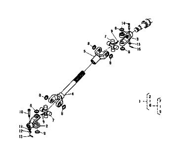

What parts do you need from this picture.
As Hudson said and deleted ??? :confused:
Depending on what parts you need, you might be able to piece it back together.

I believe he needs the mid PTO output shaft, part #96380-25160...Ouch..$347
I cant get the transmission diagram to copy, sorry...info is from Messicks
