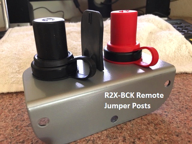

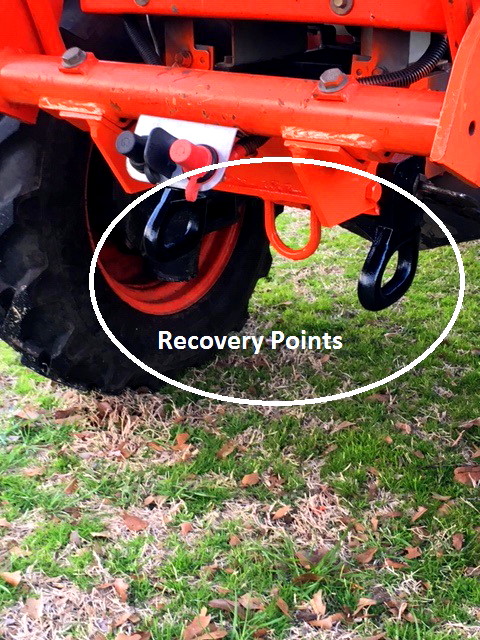

To charge or jump start, connect positive to the post on the starter, negative to any nearby bolt head. Presto.

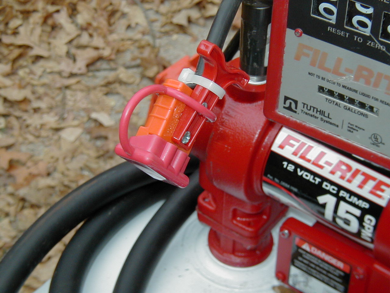

Not to change topic, but I've been looking at those for making it easy to hook up a 12V external fuel pump to my tractor for refueling. I would like to hear others that have used these and their experiences.

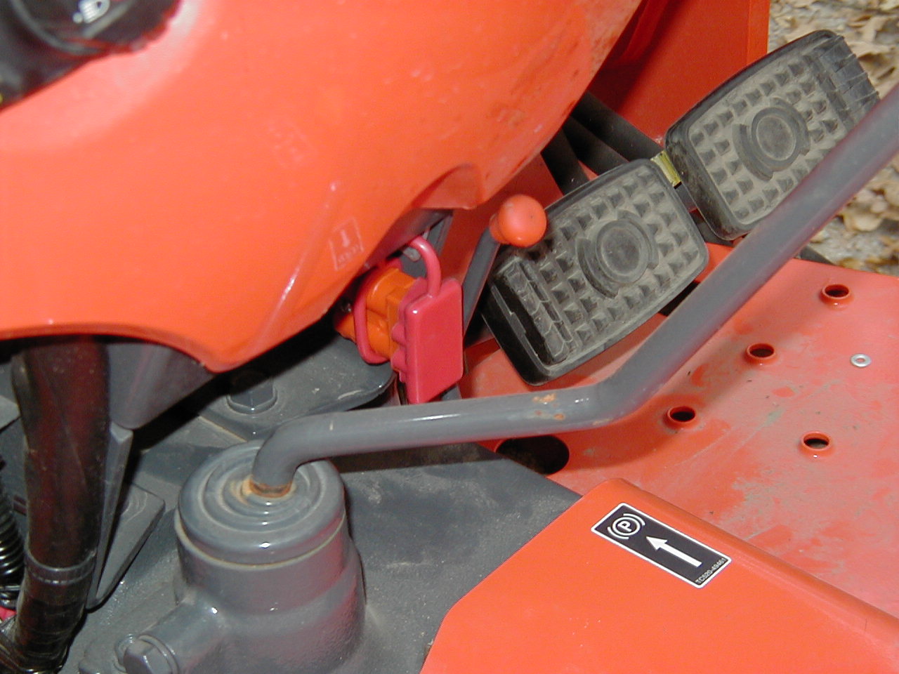

Used the cable that came with the transfer pump to run from the battery with a fuse to the connector under the dash and then put a connector on what was left of the cable for the pump.
2 - 134G1 Anderson SB50 Connector Cover
2 - 6331G12 Anderson SB50 Connector kit Orange 10/12 AWG
1 - SB50-HDL-RED Handle for Anderson SB50
Back in 2015 it was $18.96 with shipping.

Those are the connectors that I used as well. Wire one to the battery, and install wires on the other that terminate in booster cable type alligator clamps. Just make sure the wires are heavy enough to support the current running thru them when boosting.

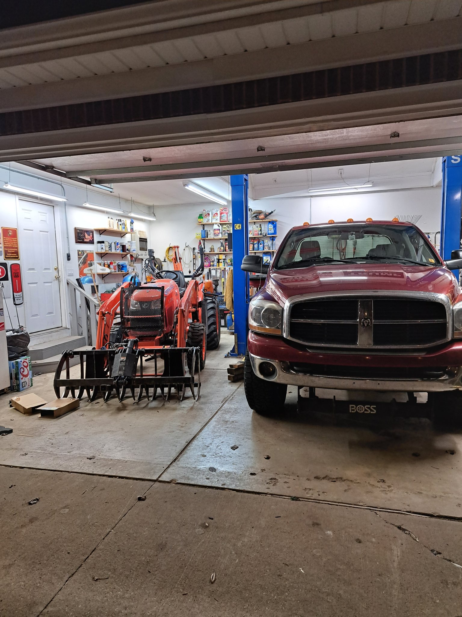

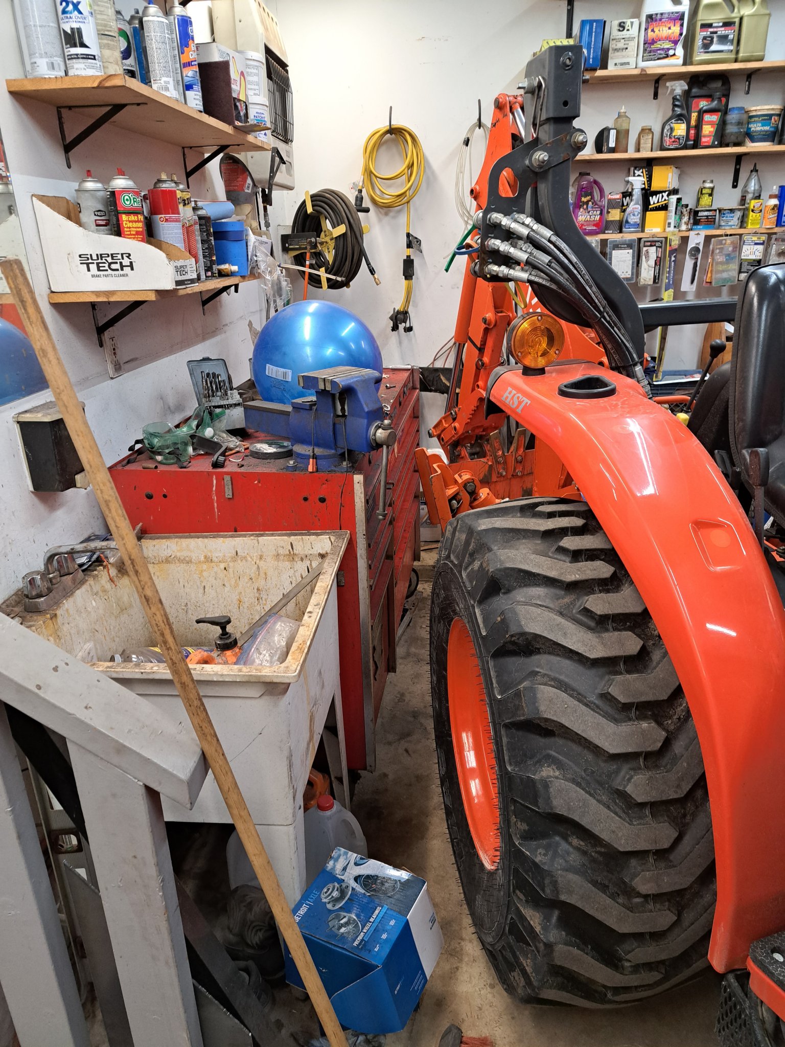

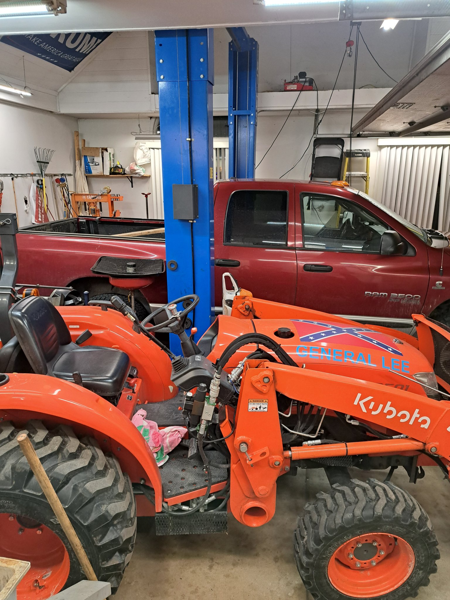

Since I brought the General Lee home to work on, I find that I have to play Tetris a lot more, so an unfortunate side effect is having to start and shut down fairly quickly.
I hate doing it, but thats life in the big city.
Since the OP mentioned charging, what brand/type of battery tenders do y'all use/recommend?
I want one that mounts "permanently" and has a long enough cord to run the plug end to the same area as the block heater plug.
Kind of a tight squeeze, but this is my reality (currently)
