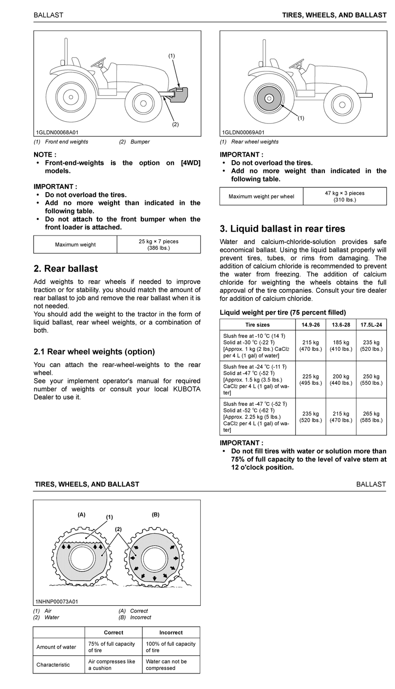

What @Henro said, beware of ignorance and misinformation. My local dealer adds liquid ballast to EVERY tractor they sell. Do you think Kubota would stand for that if liquid ballast were a problem and it caused premature transmission failuire that Kubota and the dealer would have to pay for? Kubota even recommends liquid ballast in their owner's manuals.
These tractors are built to work and as long as you don't use a corrosive liquid in the tires, ballast is a good thing.
Here are a couple of pages from my owner's manual.
