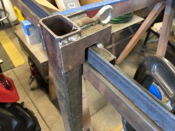

When I built my loader bucket pallet forks, I planned to build a frame to also be able to use the forks on the 3 pt hitch. Today, I started measuring and cutting steel for the frame. What I have done so far was made from materials I had in the shop. I am going to add a receiver hitch to the frame as well. It will be quick hitch compatible too in case I decide to buy a QH someday.

What size and wall thickness tubing did you use?

The forks are 2x3x3/16 wall. The frame is 2x2x1/8 wall tube, 2x2x3/16 angle, and 1-1/2x3 channel

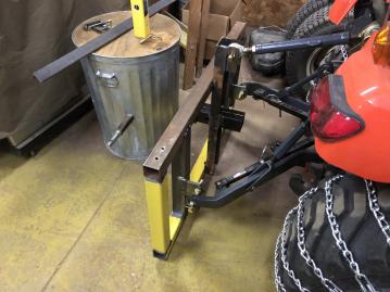

I picked up the rest of the steel I need, lower lift pins, and a 2” receiver. The receiver slips thru a hole in the piece of channel. I clamped the angle to the top horizontal tube and hung a fork from it to see what I want to do to keep the forks from bouncing off of the frame. I will probably weld short pieces of the channel towards the bottom of the forks to hook under the bottom horizontal tube. That is as long as it does not get in the way of the bucket when I use the forks on the bucket.

I added mounts to the frame to fit the loader and painted the pieces. The bucket level indicator attaches to the frame so I’ll know when the forks are level. I welded 1/2” bars to the loader pins for handles to make it easier to swap between the bucket and forks.

Put the forks on and parked in the sun to help finish curing the paint.
5,912
3,112
Very nice,
When I started reading the thread I thought why not make the forks work on the loader? Better there.
But it yours now work both places. Best of both worlds.
I love my clamp on bucket forks, but not having a bucket in the way is excellent.
Great job. I am envious!
