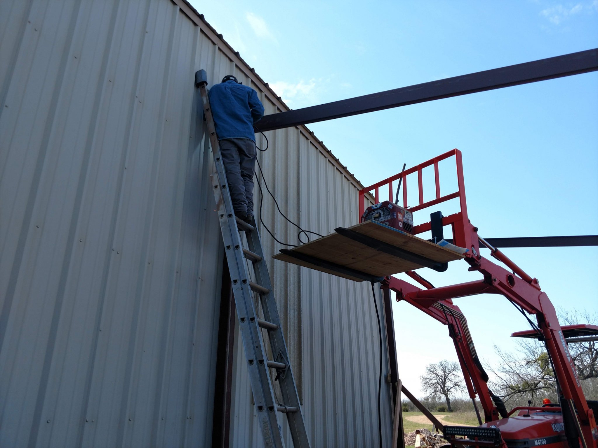

Here’s one way I’ve used my bucket with the engine not running:

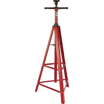

When I work beneath my raised FEL or 3-pt I always use jackstands. The high jackstand is only about $90 and I consider it good insurance.
