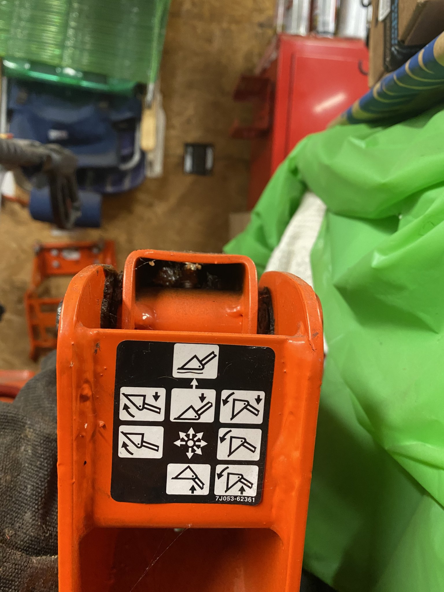

This came up a couple years ago with a person with a large tractor/loader.
Actually, Kubota FEL's are much more multi-functional than some other manufacturers.
That said, the lift/curl function is a little "finicky" on many of them from big to small....
Look at your loader's diagram of lever movements. The "7 O'Clock" section is blank for lift/curl.
Not to say it won't do it. What I notice is a small delay in action and have to move control a little....it's just that one spot...

Learn something new everyday. I know that mine will do it, I just never realized it was not indicated on the label.
