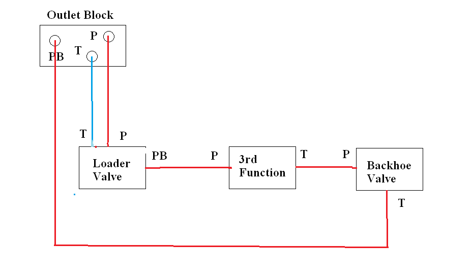

Hello all, new poster here.
Bought a brand new l4701, fel, b92 a few months ago. Also had the dealer install a 3rd function for the grapple they sold me.
Been having trouble with my b92 backhoe burning out valves. It's at the shop now for the 3rd time for this issue. Kubota says my 3rd function is burning out the valves and I will need to disconnect my back hoe when using the grapple...?
Is this normal?
Any help is greatly appreciated :)

The valves for the backhoe, they get really stiff to the point I can't use a certain function. I've had outrigger valve replace, bucket in, boom out...

The last valve that went bad was boom out. While operating the tractor I can start to hear pressure building up from the backhoe. When I reach back and jiggle that function it will go away for a while...

Oh sorry, I meant to say disconnect the hyd line to the hoe

I think somebody is blowing smoke up your nether parts. Sounds more like the plumbing has been botched. The third function valve should be installed ahead of the backhoe. In the case of an L4701 that would be just after the loader valve and ahead of any remotes. It could also he installed between the outlet block and the loader valve. IT CANNOT BE INSTALLED IN THE BACKHOE RETURN LINE. If they plumbed it in after the backhoe it WILL back pressure the tank return line on the backhoe valve which can potentially damage the backhoe valve. Damaged seals in the backhoe valve is the usual result and that sounds suspiciosly like what you are experiencing.
Kubota is quite clear on this - ALL auxiliary valves need to be ahead of the backhoe.

My proposed diagnosis is based on remote analysis of repeated hydraulic failures. It relies on nothing more than basic hydraulic knowledge and a passing familiarity with Kubota's design practices. I dont need the machine or the installation documentation to arrive at that diagnosis.
This is the third occurence so something is clearly wrong. The technician doing the work cant see the pattern, diagnose the apparent cause, and correct the order of the valves. Service department management appears to be equally clueless and the explanation they hsve given to the customer is nonsense.
That leads me to believe they all lack a basic understanding of the simple open center hydraulic circuit they were tasked with configuring and installing.
If that is truly the case then that entire service department is bad, really bad, and they need more than better written installation guides.

Please don't tell them I said they were incompetent although that's my suspicion. Hang on and I will send you diagram of the correct plumbing. Did you get factory remotes with that tractor?

Well sounds like it was installed on the back end. Tech was good about it all and they are going to look at it and try to correct it all.

I would be impressed if they told you they F'd it up big time subjecting your new backhoe valve to damaging back pressures. And since they can't say for sure that it has not been compromised beyond what they have already seen they are going to replace it with an all new unit. My guess is that isn't going to happen.

They said they were going to replace the entire bank of valves. I imagine that's when kubota stepped in and they came up with unplugging the hoe Hyd line, being it was the 3rd time....
Was there anything else other then that valve bank that could have been damaged?

The backhoe valve is the only thing in danger of damage. Messick wants $3562 for a new one so it would not break the bank for a dealer and even less so for Kubota.
