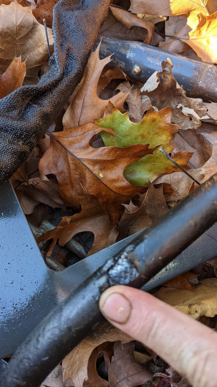

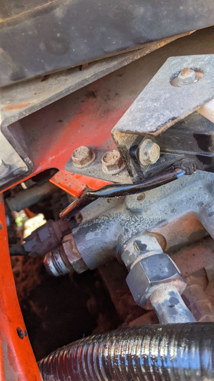

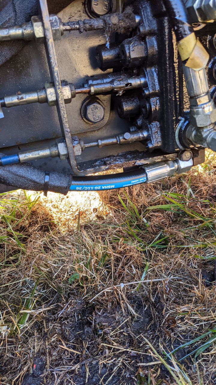

Thanks for the advices. I fixed it in the field. It was jammed in real tight against the frame and it rubbed through the sleeve and the hose.
It wasn't too bad to get to. Just was hard to identify which hose. It was the hose on the bottom of the loader valve to the top of the gear case/main pump - I guess that's the power beyond. I took it to O'really and they set me up. Topped up with my last gallon of SUDT and got it back home for some degreasing and cleanup + greased everything real good everywhere. All better.
