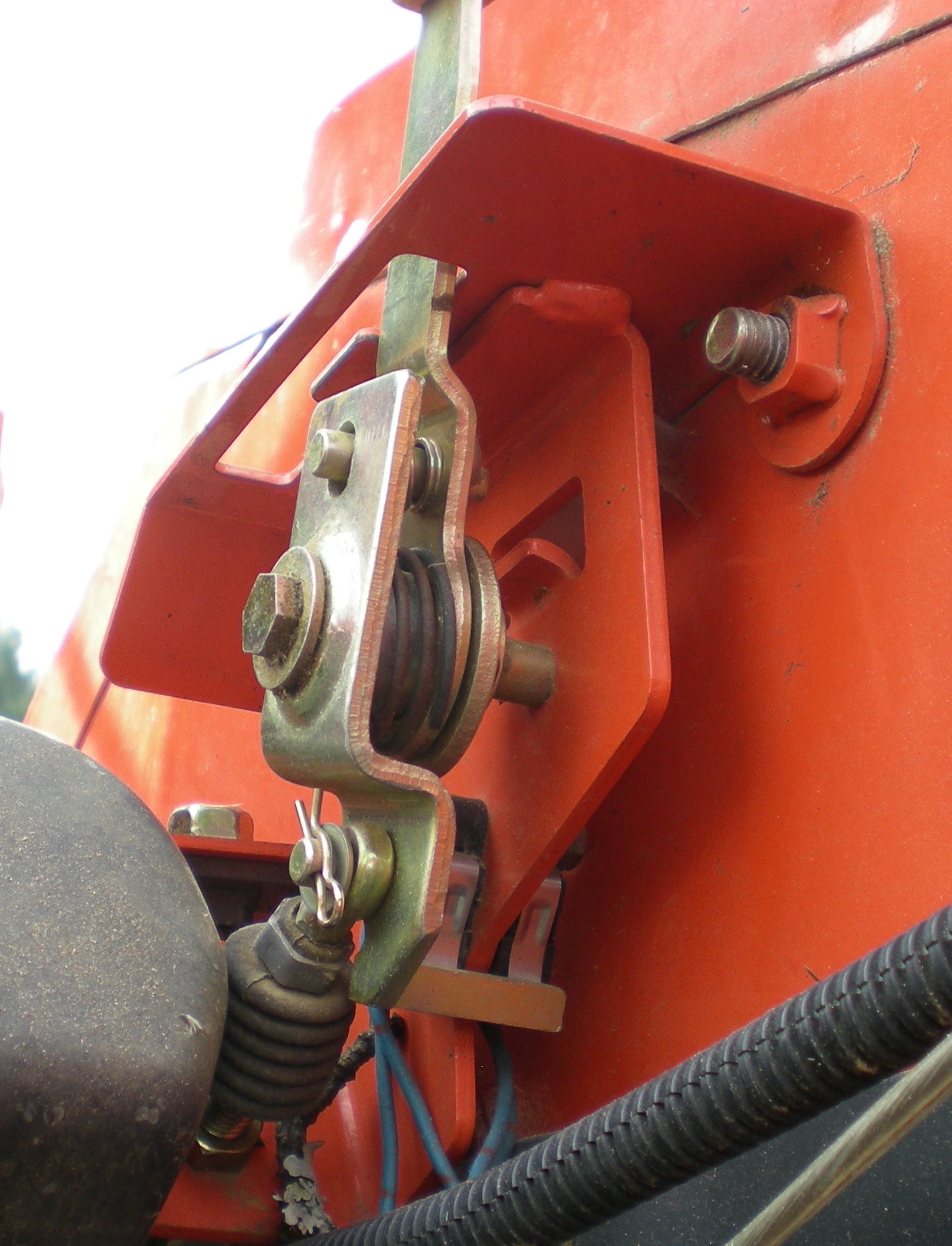

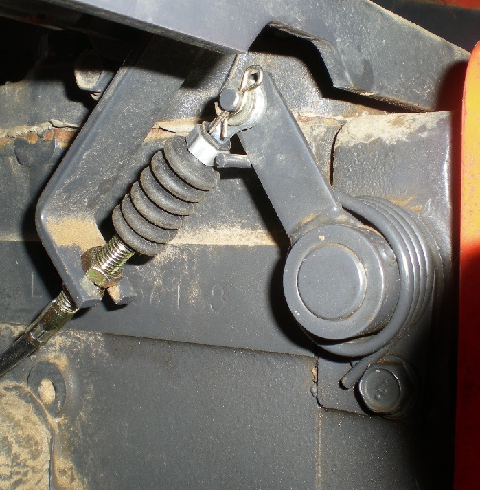

WHAT model is it (other than a L3400); Gear or Hydrostatic? Since it's two completely different ways to engage it.
If it's HST, try to lube the cable and make sure it's moving and not broken... The older HST had a smaller PTO bracket that was prone to breakage. The replacement bracket (hst) is larger...

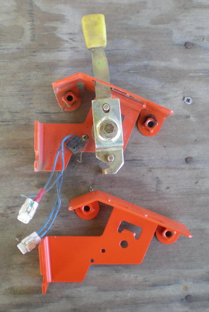

I think the gear model is a direct handle to the 3rd photo (not 100% sure).
