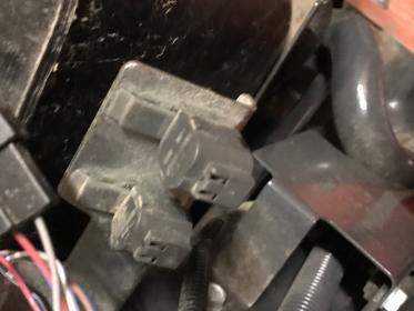

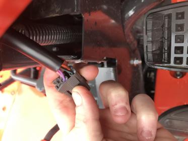

Had a dog ( that passed ) eat parts of my wiring harness
On my l3301 ... have the tractor running but it’s is in “ limp mode “ I am missing two parts ... have spend hours online and at the Kubota store trying to figure out what and how to get replacement parts .... they’re answer is a complete new wiring harness for $1100 plus labor .. any help would be great .... the have the parts that I took from of a new Kubota l3301

Are you looking for a replacement plug like the one your holding in your hand in one of the pictures? Do they mate with the two blank connectors?

Usually you can repair instead of replacing a whole wiring harness.
In the first picture, does the arrow point to the mates that you are wanting to replace? Are the parts connectors or something else?
Are those the two connectors that go to the rear harness?
Suggest that you take a picture showing the general area of the repair, (location to fuel tank, control panel, or other location).
Then a closer look, refer to the picture with text telling us what needs to be repaired.

Second comment: I had a similar problem with my used tractor...damaged by mice probably, and Messick's 800 number worked for me. Their technical assistant emailed me a wiring schematic within minutes of my request. The color coding of the wires were properly identified and I simply patched the harness without much trouble at all. The connectors which you show in your pics are not important except to make a harness easily replaceable.
Clearly that's ridiculously expensive.... all you are required to do is connect the color-coded/identified wires to each other, and you can use ordinary, simple, connectors.... either male/female crimp-connectors... or butt-splices (if you expect not to have to disconnect them in the future.) I"d probably do the latter.

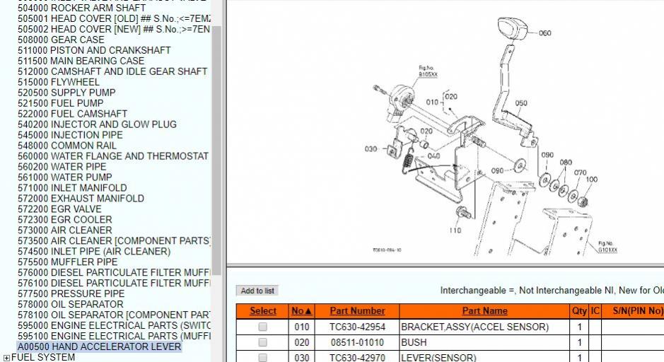

this is the parts diagram Reference fig # a005xx
I'm really good at interpreting tech speak, but you're losing me, You really need to use normal language to explain what you are trying to get.
This is parts diagram A00500
I don't think you want this!
