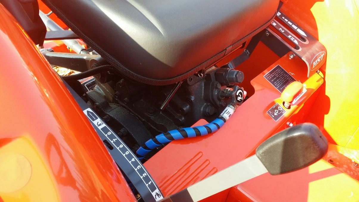

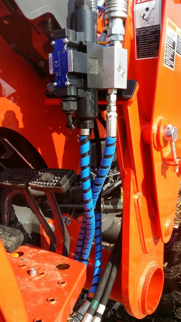

Just to keep this updated/closed,
I talked to Land Pride, they gave me instructions for the 3301 (dealer says the only thing different between 3301 and 2501 is motor). There is a steel line that connects right under the seat (near hydraulic shutoff valve for PTO), the long line connects there and the short line (provided) connects to the location on the hydraulic block (under right foot, hydraulic junction block) that the metal line connected to.
Basically, you are removing the steel line (under seat - under right foot) and replacing with the 3rd point hydraulic valve.
Corey
coreyperez
Jul 17, 2015
26
North Pole

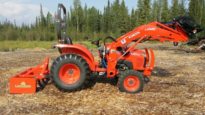

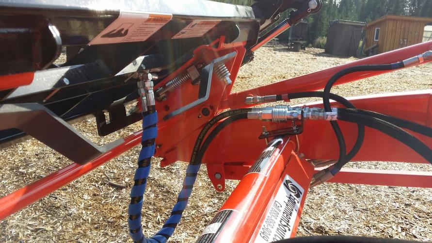

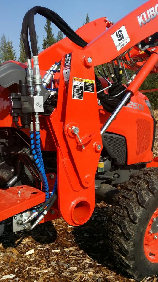

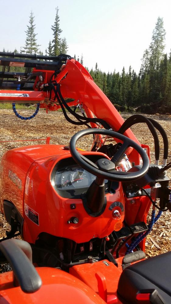

Re: L2501 "Power Beyond Port" connection for Land Pride 3rd Hyd point / Grapple
Attached are the install photos. Works as advertised!
Corey
