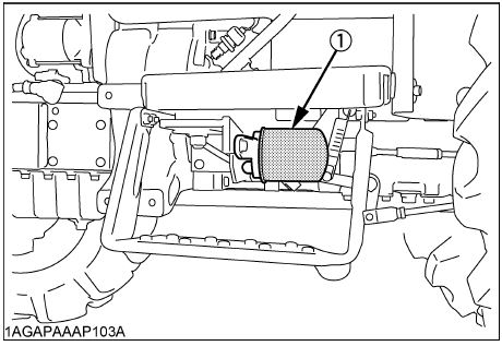

The owners manual states to replace the "transmission oil filter" and "hydraulic oil filter" at 50 hours. My dealer sold me only the transmission oil filter (Part #HHK70-14070). Is there only one to replace at 50 hours or are there two filters on the L2501 HST that need to be replaced?

Yes, the manual states the HST filter should be changed. Which is what they supplied to you. If it was mine, I would do both. For another $40 for going another 300 hrs.
Not real hard to change medium sized filter wrench and a drain pan. Spin off, spin on.

Would you know the kubota part # for the hydraulic filter that should be replaced at 50 hours and its location on the L2501. Thank you.
HH3A0-82623 One is located under the footrest on the right side and one under the footrest on the left side. One mounts vertically and one mounts horizontally. I don't have my tractor at home right now and can not remember which is which. Go to youtube and do a search for Kubota 50 hour service. There is a very good video that will help explain a lot.
