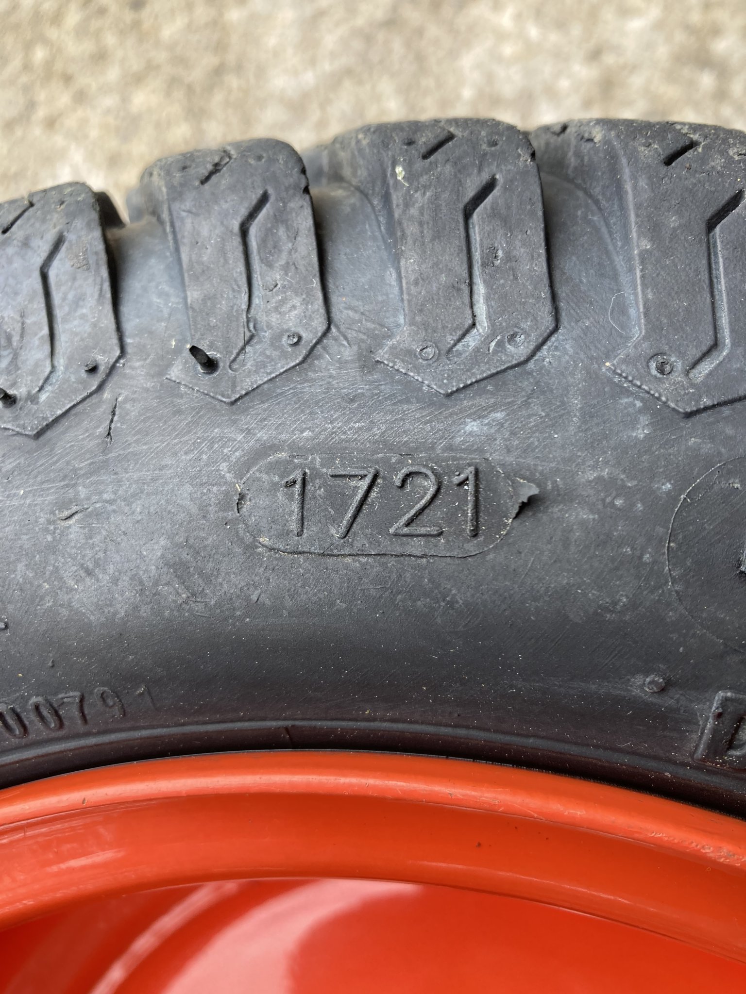

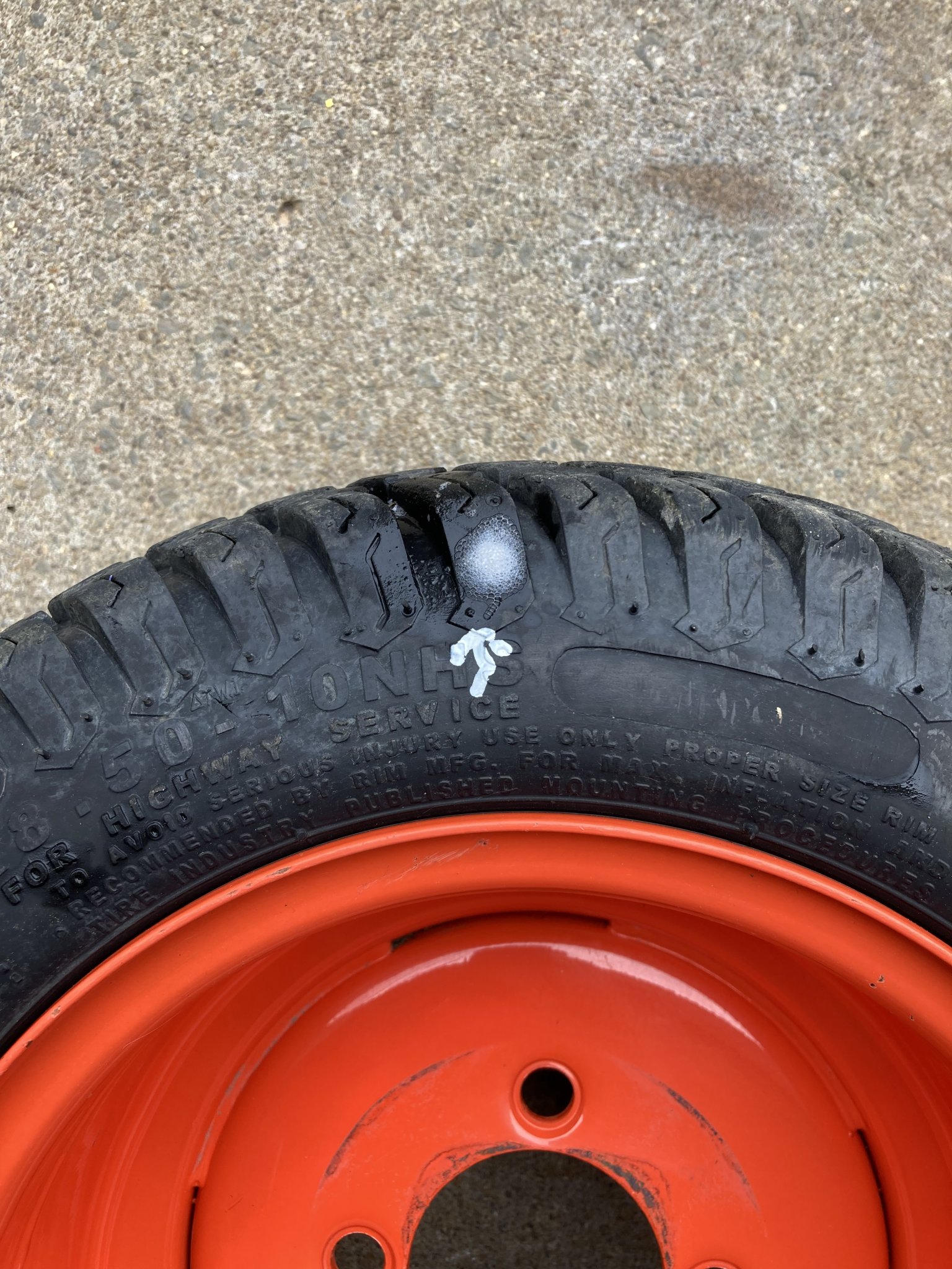

Hi folks! Used my BX2380 today and noticed front tire was almost flat. These are the 18x8.5x10 Grass Master turf tires. I had them at 20psi( max on sidewall listed is 22psi) to move some dirt last week, and also last fall moved quite a bit. I only used the turfs because the R14T tires would have torn up my lawn. I also ran into this problem with the front turf tires on the BX1870 I had, but those were in their 6th year, these ones are in their 2nd( date code of 1721). The tread likes to split in the sipes going down side of tire. So some quick research I can either buy a new pair on ebay for about $120, or tube it. Posts have been made saying there is no 18x8.5x10 tube, that they used a 18 x8.5/9.5x 8 size tube. So I stopped by Harbor Freight and they had the 8” tube in stock for $9.99. It does have straight stem, as I was looking in posts if they mentioned straight or angle stem. I hope it works. I will not Slime the tires, as it is nothing but a mess if I ever have to replace the tire.

What I would do is get the existing tires foam filled by an industrial tire shop. NOT that expensive. Did it twice on both of my tractors. My son in law's BX23S as well.

My 1880 front tires went flat when using the loader. Pumped them up to max pressure shown on tire. No issues now on my turf tires.
