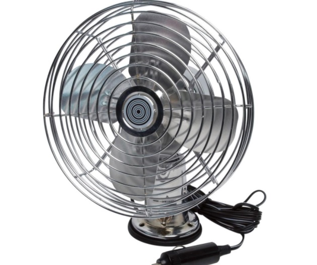

I put an electric fan blowing on the windshield in the cab on my B2410. No heater in cab.
It works great for keeping it from fogging up. For some reason I think they are called a bus fan.

I put an electric fan blowing on the windshield in the cab on my B2410. No heater in cab. View attachment 51879 It works great for keeping it from fogging up. For some reason I think they are called a bus fan.
Never thought of that I drive school bus, and we have them in the bus lol thanks
