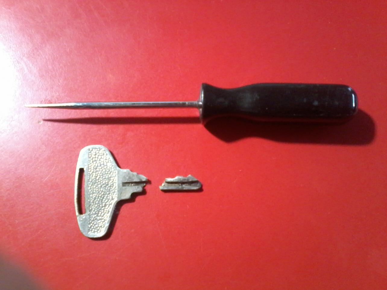

Got it!!! First I gave it a squirt of Fluid Film (see pic), then a sharp hole punch. I lightly tapped the punch with a 6 oz hammer creating a small indent, then was able to work the piece out. Lucky or what!
Thanks for all the suggestions, now I have to find a new key. Fluidfilmcan.jpg

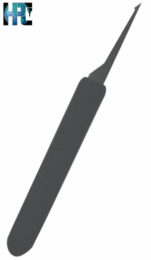

Most lock pick sets come with an extraction tool like this:
A little careful grinding on a broken hacksaw blade will yield the same thing.
