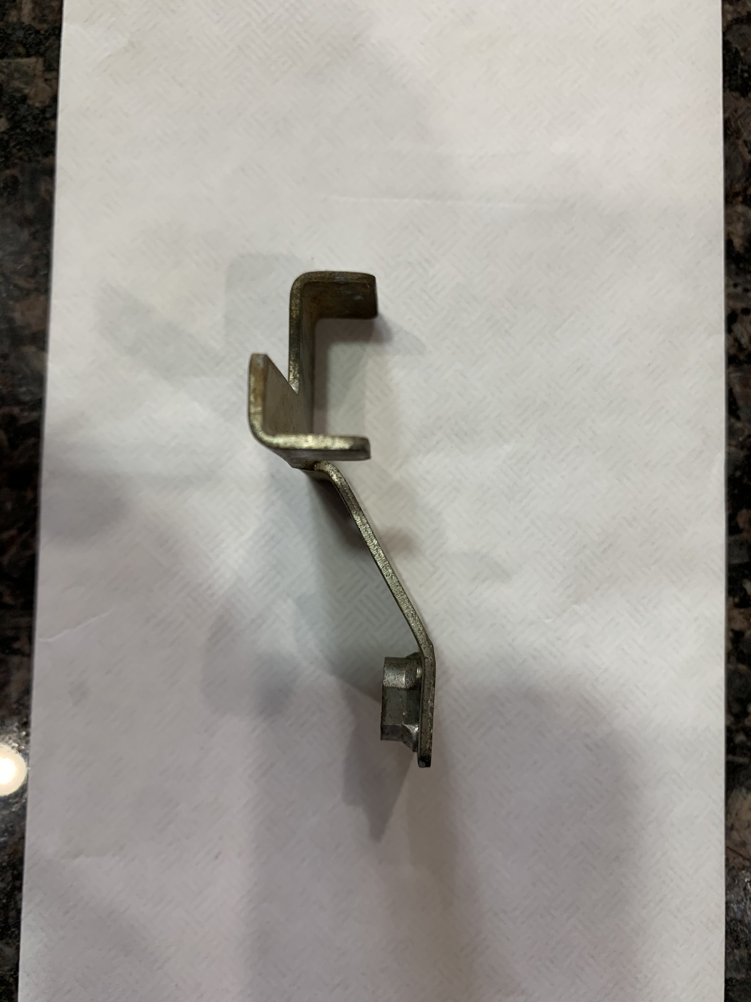

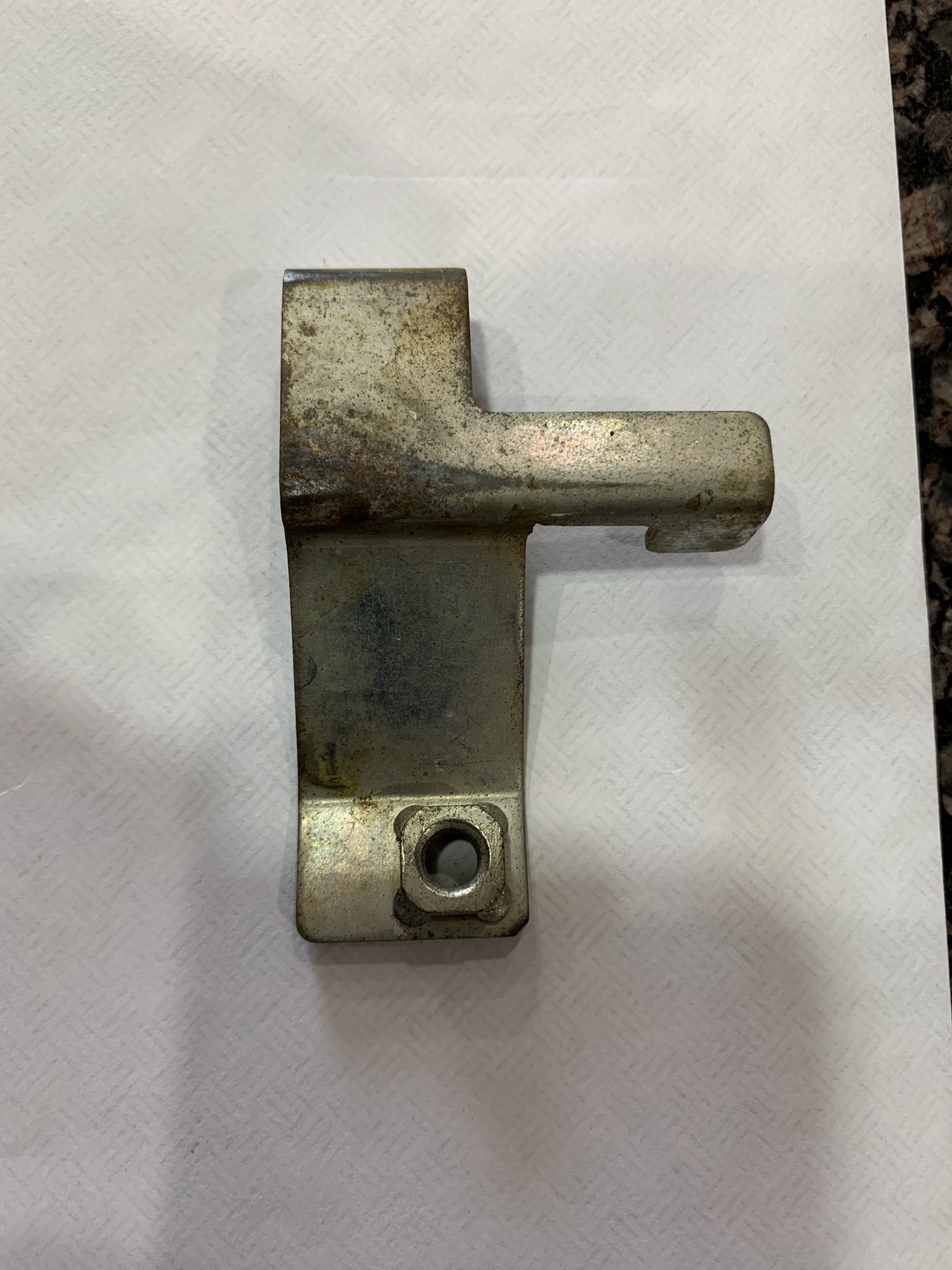

Pa Pow hit it on the head. I have it working properly now BUT.....
when I removed the plastic cover to get at the controller.....the problem fell out. I just cannot for the life of me figure out what this part is supposed to do or where it is supposed to go. It’s clearly a stop bracket of some sort. But I couldnt find any place that it needs to be bolted to. I am attaching 3 photos of the part in case any of you have seen where it might go.

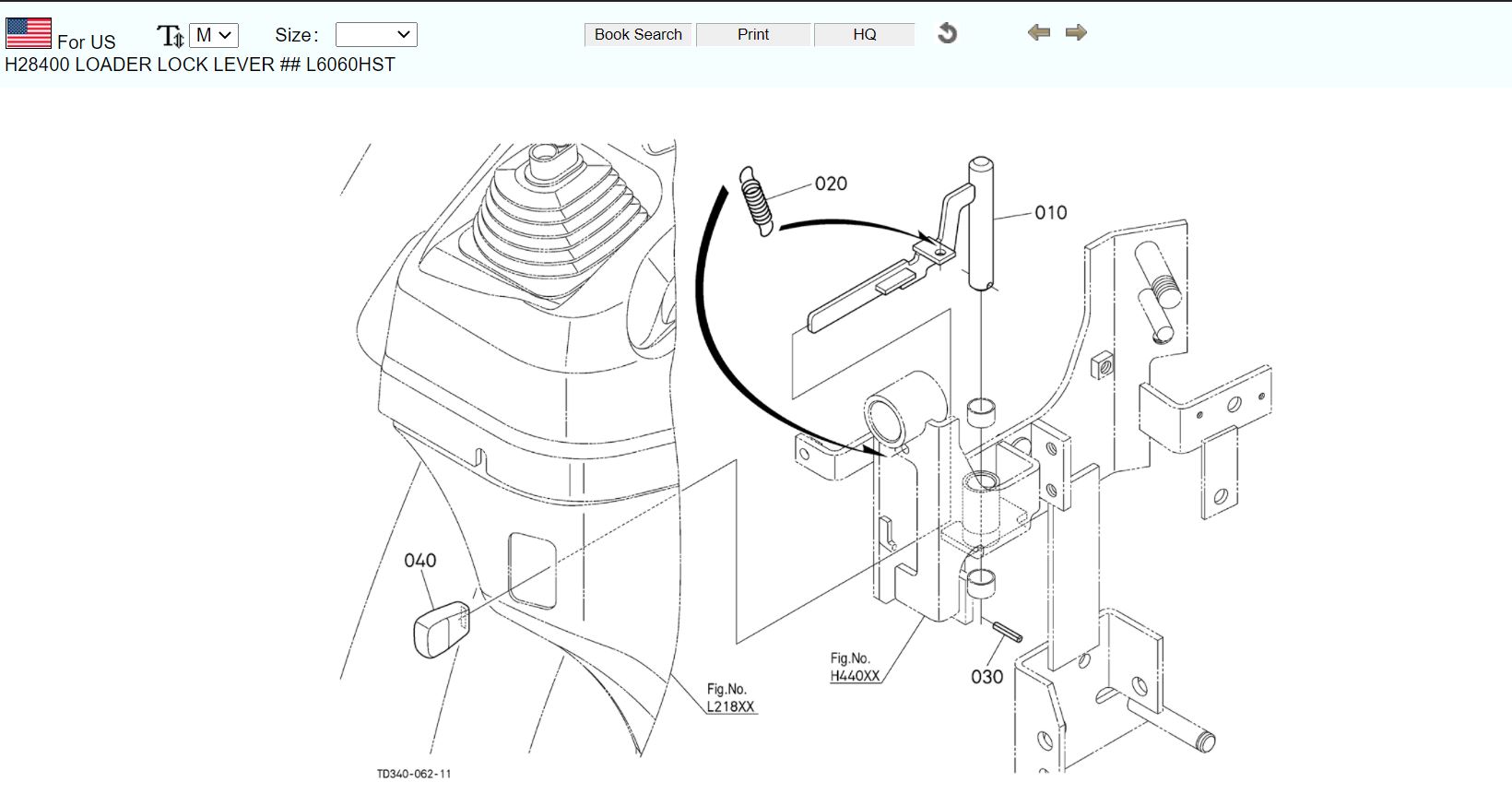

Part of a joystick lockout mechanism??? If everything works without it.

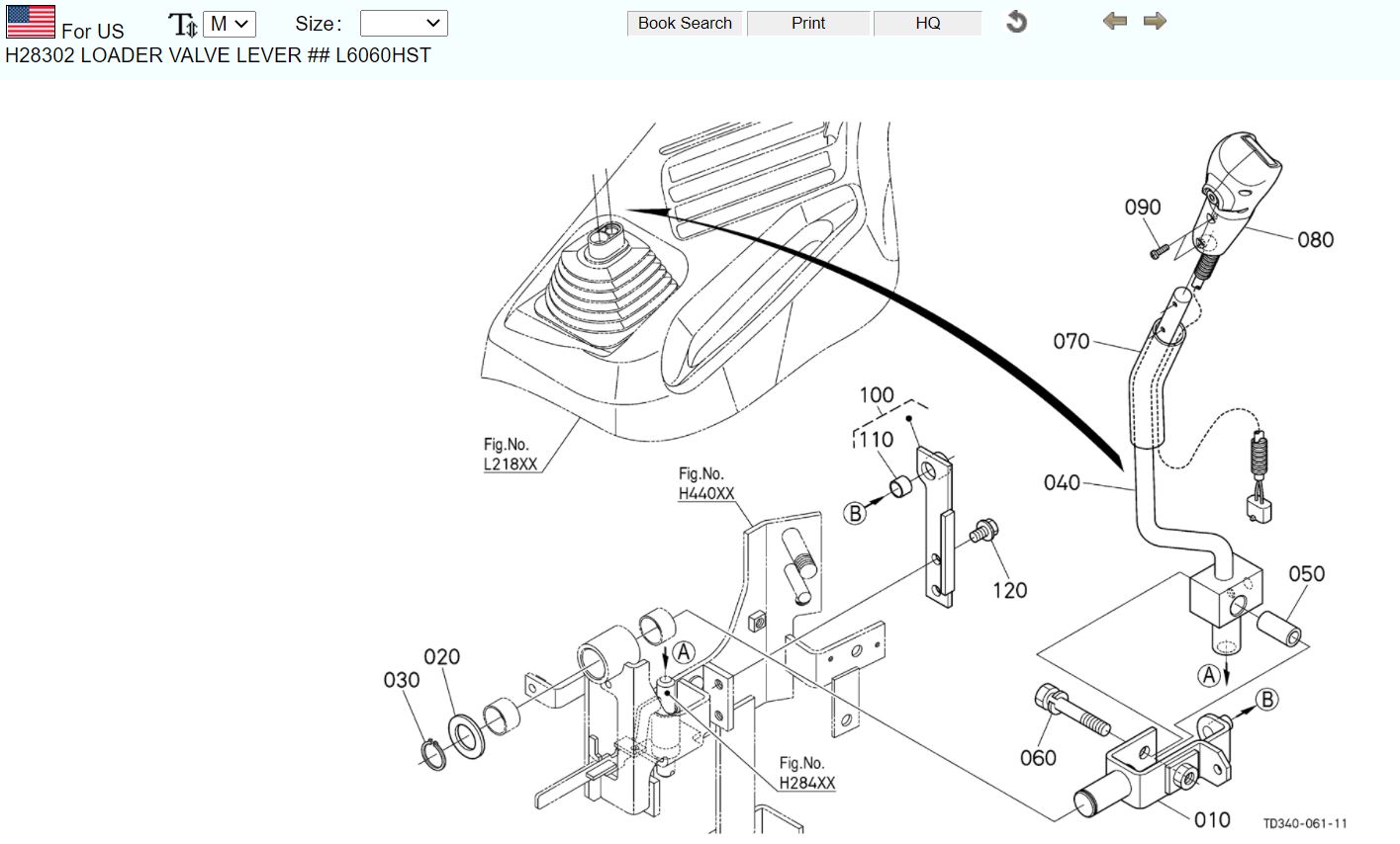

Do these look right? They can be found here:
