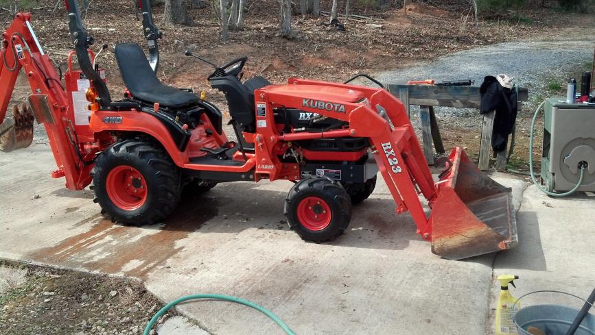

Well, things changed quickly over the past 4 days. I was offered a 2005 Kubota BX23 with loader and backhoe for $8800. The BX23 has 400 hours and has been well maintained and garage kept.
I decided to buy the BX23 this morning with the hope I could sell my B7100 quickly. Unbelievably my B7100 sold this afternoon. So for around $3800 I have a loader, backhoe, and 12 year newer tractor with half the hours.
I do appreciate all the replies and have been having fun learning my "new" orange tractor.

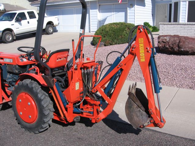

The 1980 sales brochure for my tractor shows a front loader (presumably a B219) on all three models B5100, B6100, B7100. I have seen the B219 loader on each of these models, but I'm not sure if there are mounting variations for each. The nomenclature tag should be on the inside of the left upright if it is a B219 loader, and maybe someone who has the models in question will know more about the mounting variations, if any.
Here's my B7100 with B219 loader:
I know this is an old thread. But which backhoe is on the tractor?
7,754
2,898
B670. This was the factory option for this model. Pretty hard to find, and usually thrashed.
