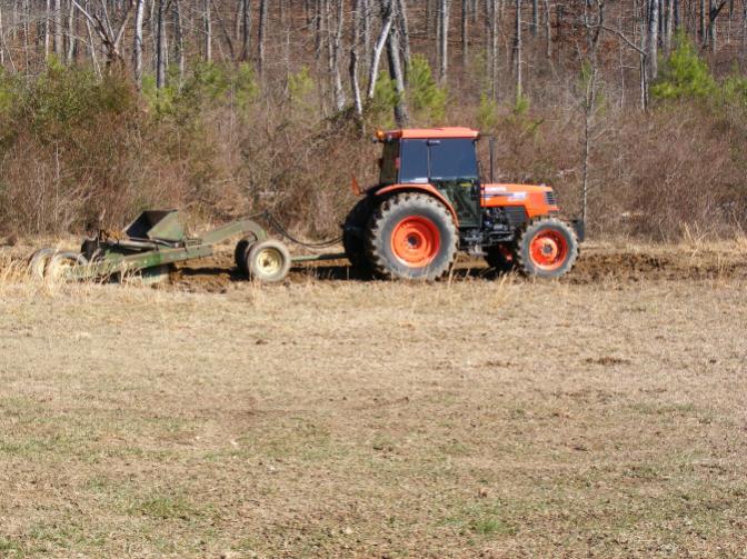

Like your tractor bulldog. NICE ONE mine is a baby compared to yours but I take a little bite at a time.handy
Bulldog
M 9000 DTC, L 3000 DT
Mar 30, 2010
5,434
76
Rocky Face, Georgia
Thankyou handy,
That is the one I was sitting in when I was on the phone with you yesterday. I really do love that tractor. It sure is a lot better in the field than my other one with no cab.
