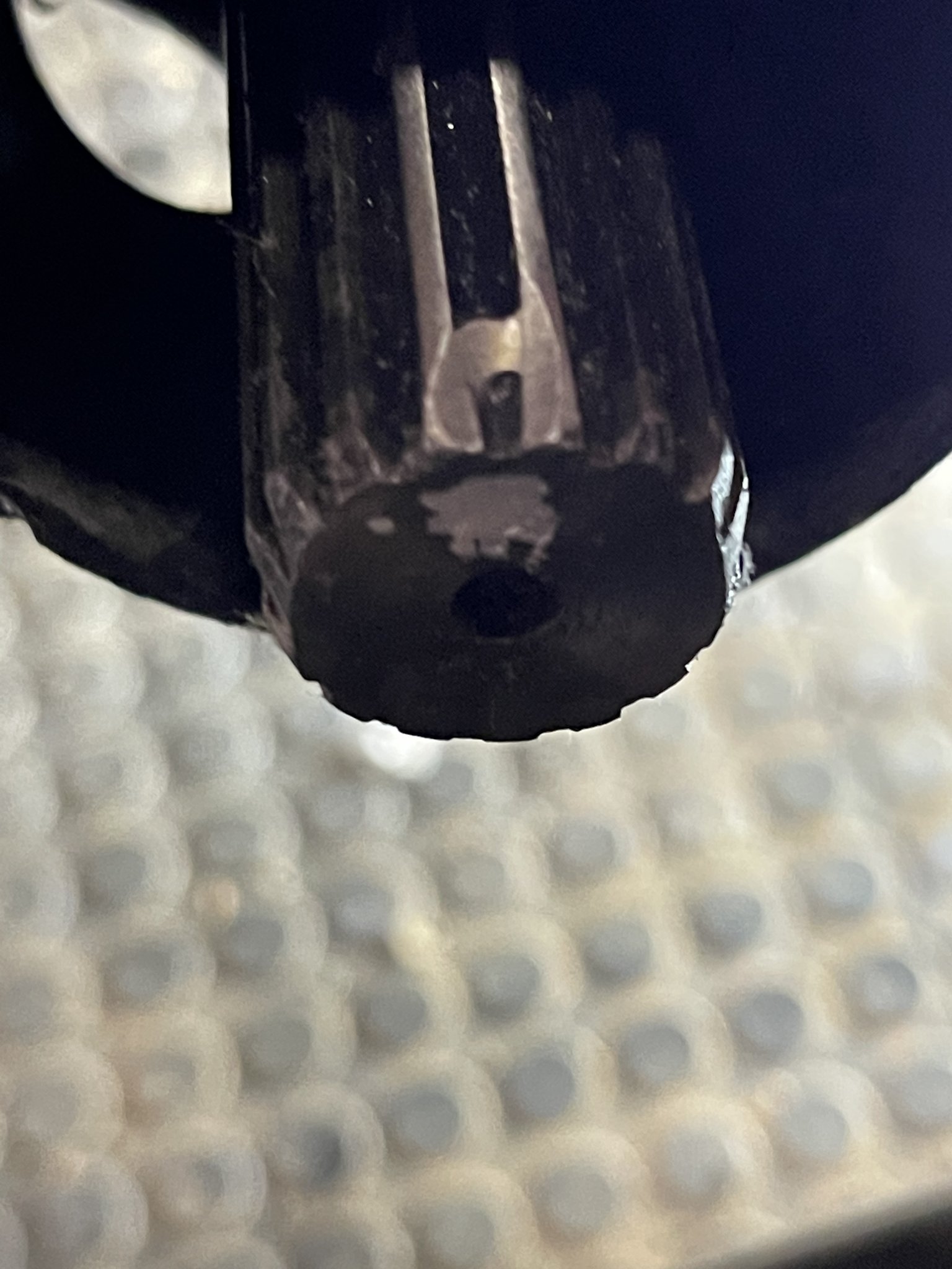

I believe i have a similar connection type and it is "keyed". Look carefully and you will see it(photos below). Mark it so it's not such a pain to connect next time.
