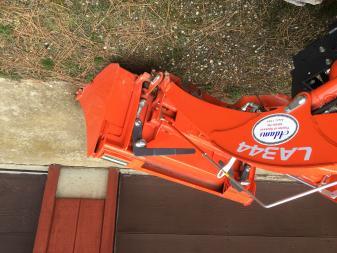

I agree with tiktok its very straightforward process. The hitch is obnoxiously heavy though.
Agree the hitch is a bit unweildly and you have to kind of "latch" it over two hooks on the tractor that can be a bit tricky to get just right. I also crushed a finger grabbing the drive engagement lever thinking it was a solid hand hold doing it the first time.
I've heard claims that the loader will still fit on with the hitch installed but I havent tried.
To me the biggest gripe with the blower is that in my opinion, a blower thats a few grand should come STOCK with hydraulic or electronic chute direction AND angle. I'm fine with the manual controls but it seems to me for a nearly $4,000 setup, they should be able to include those options. To ask someone to spend almost another $1500 just to get automatic chute and angle adjustments using the hydralic lines that are already there and unused from the loader just seems like gouging.

No, Not quite. that is the SSQA for the loader and isn't used for a blower attachment. In fact, you must remove the loader to use the front mounted blower. That's why some chose to get a rear 3 pt mounted blower (less cost).
Here is the kubota video on the 4pt hitch for the blower...
https://www.youtube.com/watch?time_continue=30&v=j6Cm40Ch0Bg
