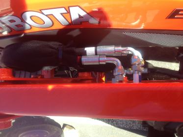

So I went into the dealer and they have new hoses on order for me under warranty. No issue.. The funny part is when we went to the brand new tractor on the show room floor to look at the hoses on the loader it had been installed incorrectly as well and the hoses were already chafing. I think is is more bad design for the LA534. Went to look at a LA434 on the floor and the routing of the hoses are much better. Attached a pic of the LA434.
