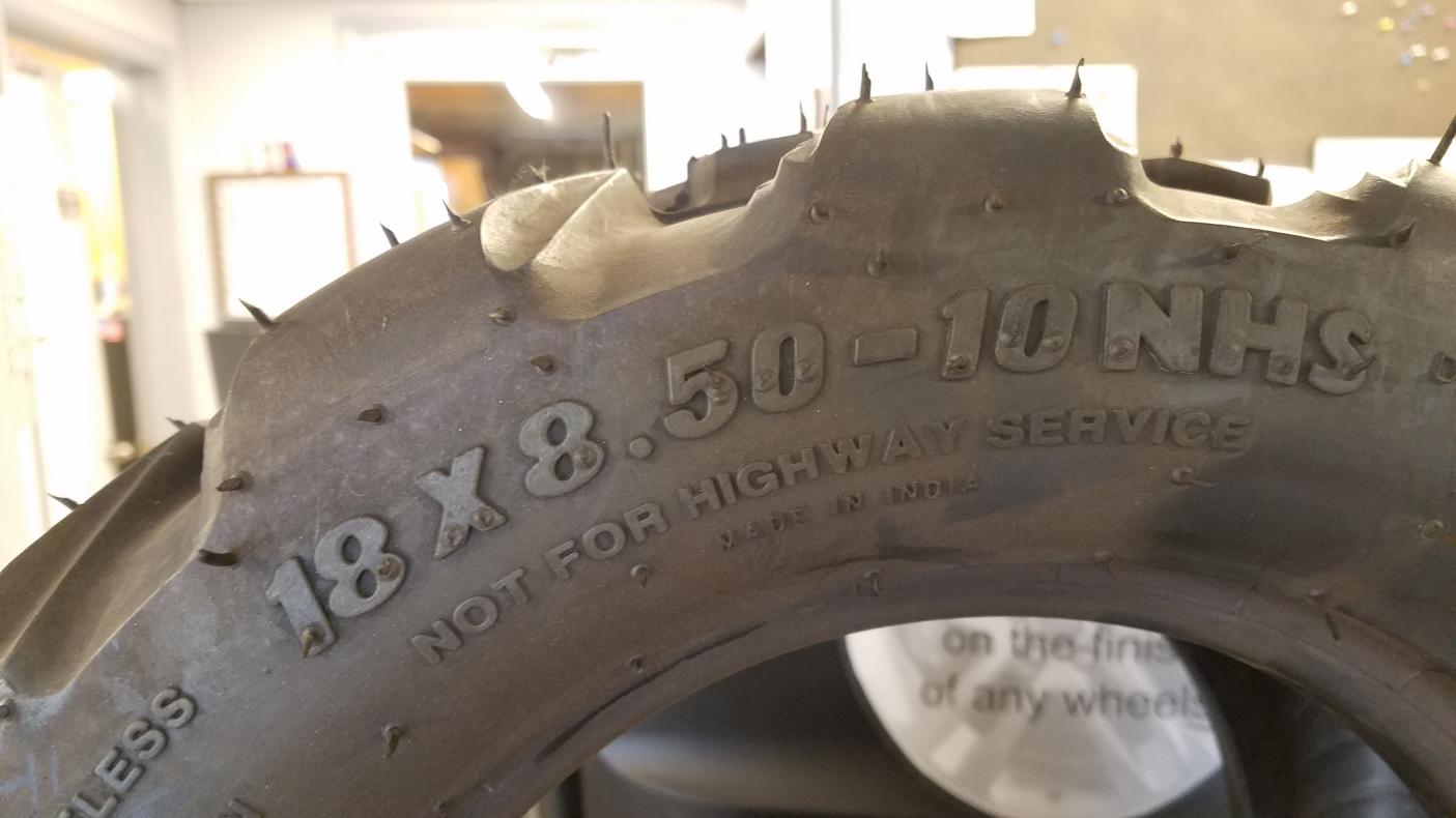

They're aren't quite as aggressive in person. I snapped a couple pics of the one he showed me.

Thanks Dave. I've thought about ordering directly from them too - but was hoping to see if anyone had any experience with these ones first. Trying to get something with a sturdier sidewall than the OTRs. I still might go that way - not sure I like the idea of putting tires designed for a skid steer on my BX since I probably use it for mowing 85% of the time. Don't really want to find out they rip up my lawn after the fact.
