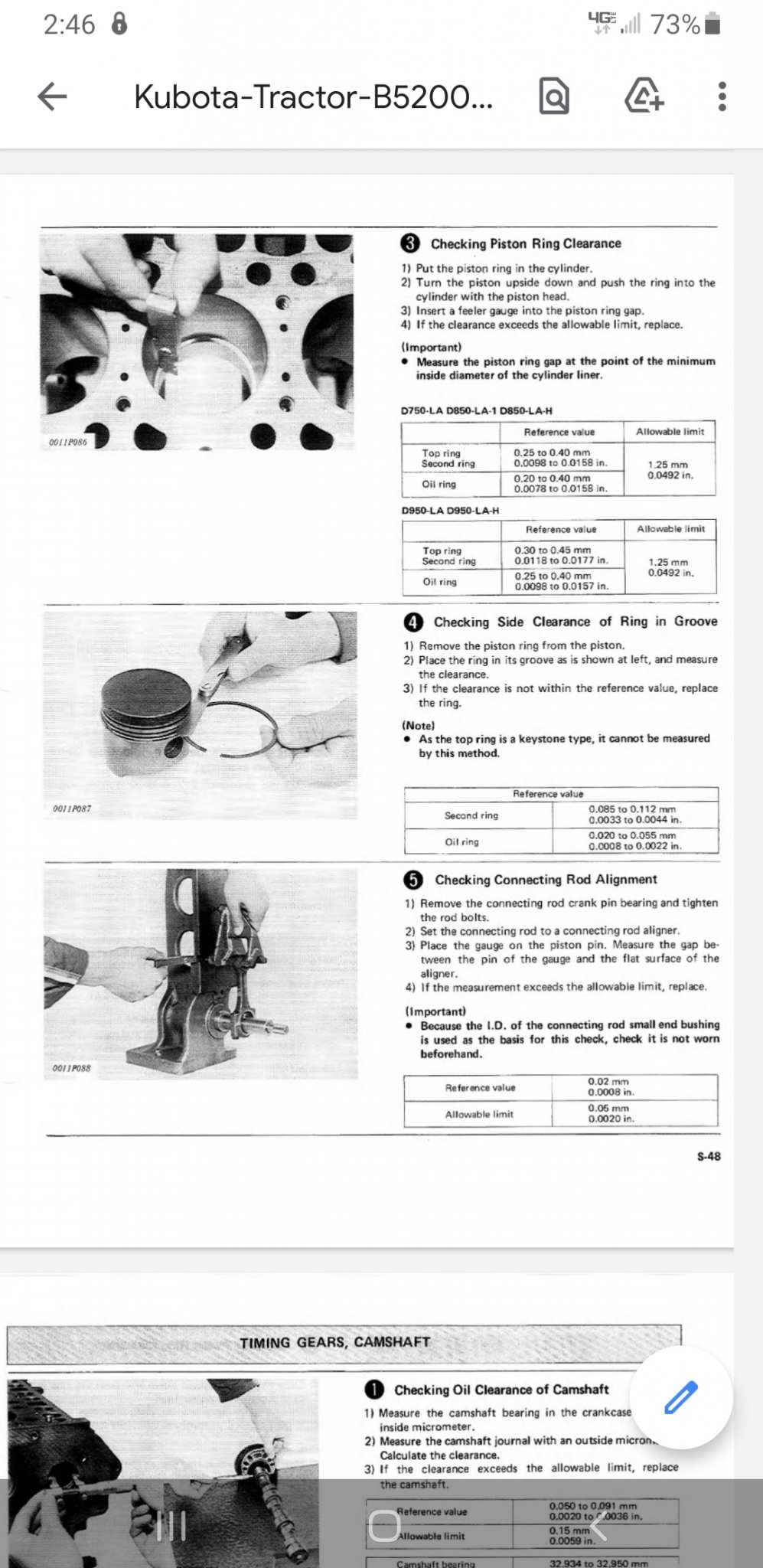

I have a question I hope someone can clear up, I have a b7200 with a d950lah engine I'm rebuilding, trying to find the correct ring gap has me concerned as I've found that everyone says it starts at 00.17mm up to 32mm but a book I downloaded says different it says .30to.45mm ill try and put the picture of it up. Everything else in the book seems ligit whys this different?

I do not know WHO ..”everyone says”.... IS. I would follow the written guidance in the Kubota WSM.

I'm not trying to throw anyone under the bus or anything like that but I've read it on this site,there was even pictures posted showing all the specs, so I was going by that but I downloaded some wsm digital books and they say different I dont know what to go by thats why I was asking. Even the 2 kubota books had 2 different ring gap specs.if ut wasn't such a big difference i wouldn't be that worried about it but .17mm to .35mm compared to .30 to.45mm seems like a big difference.any help would be greatly appreciated.
