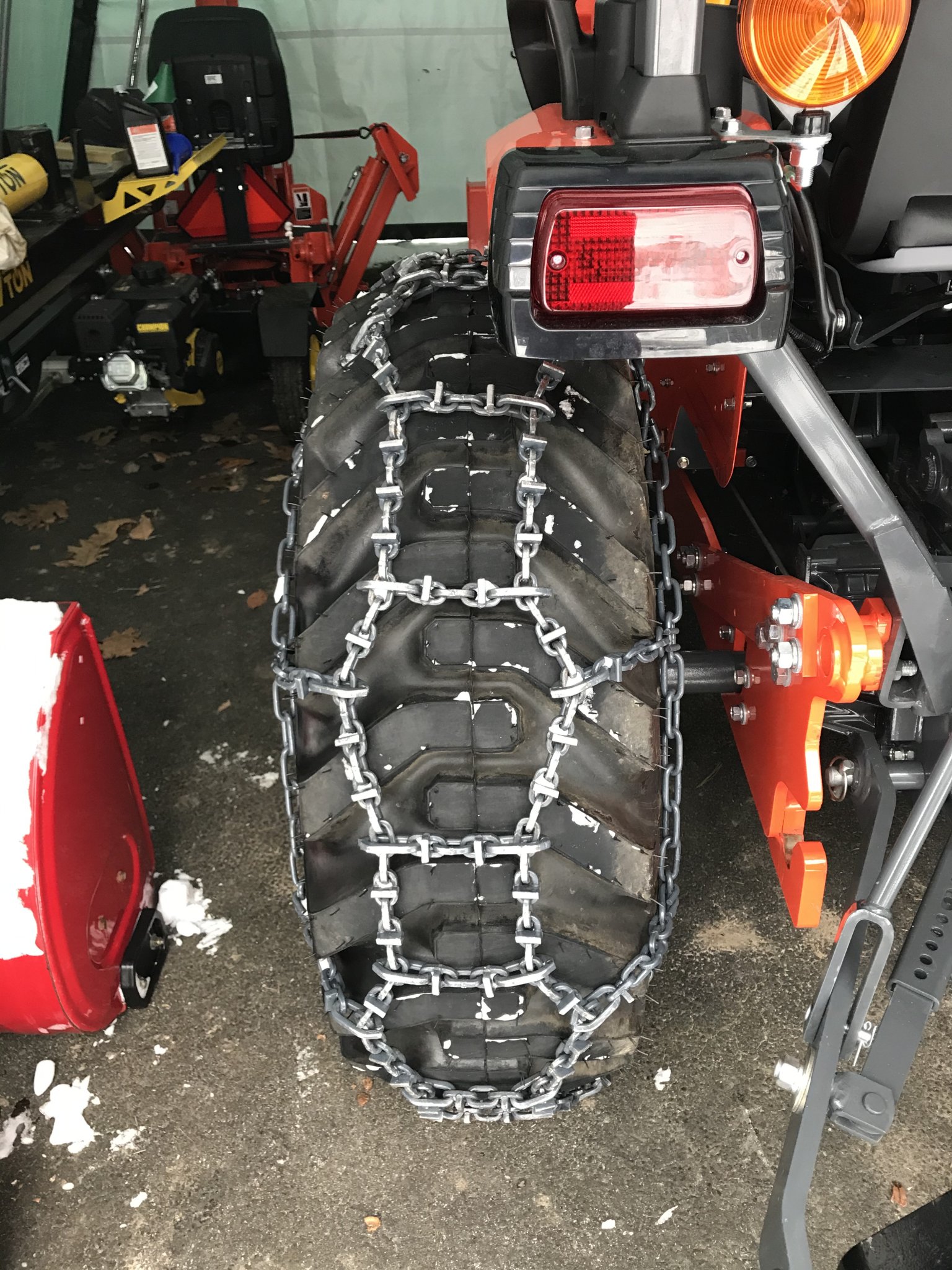

The Aquiline MPCH’s pattern keeps them on top of the tire

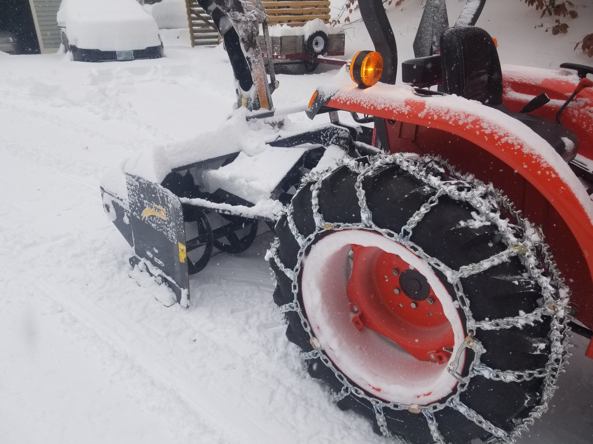

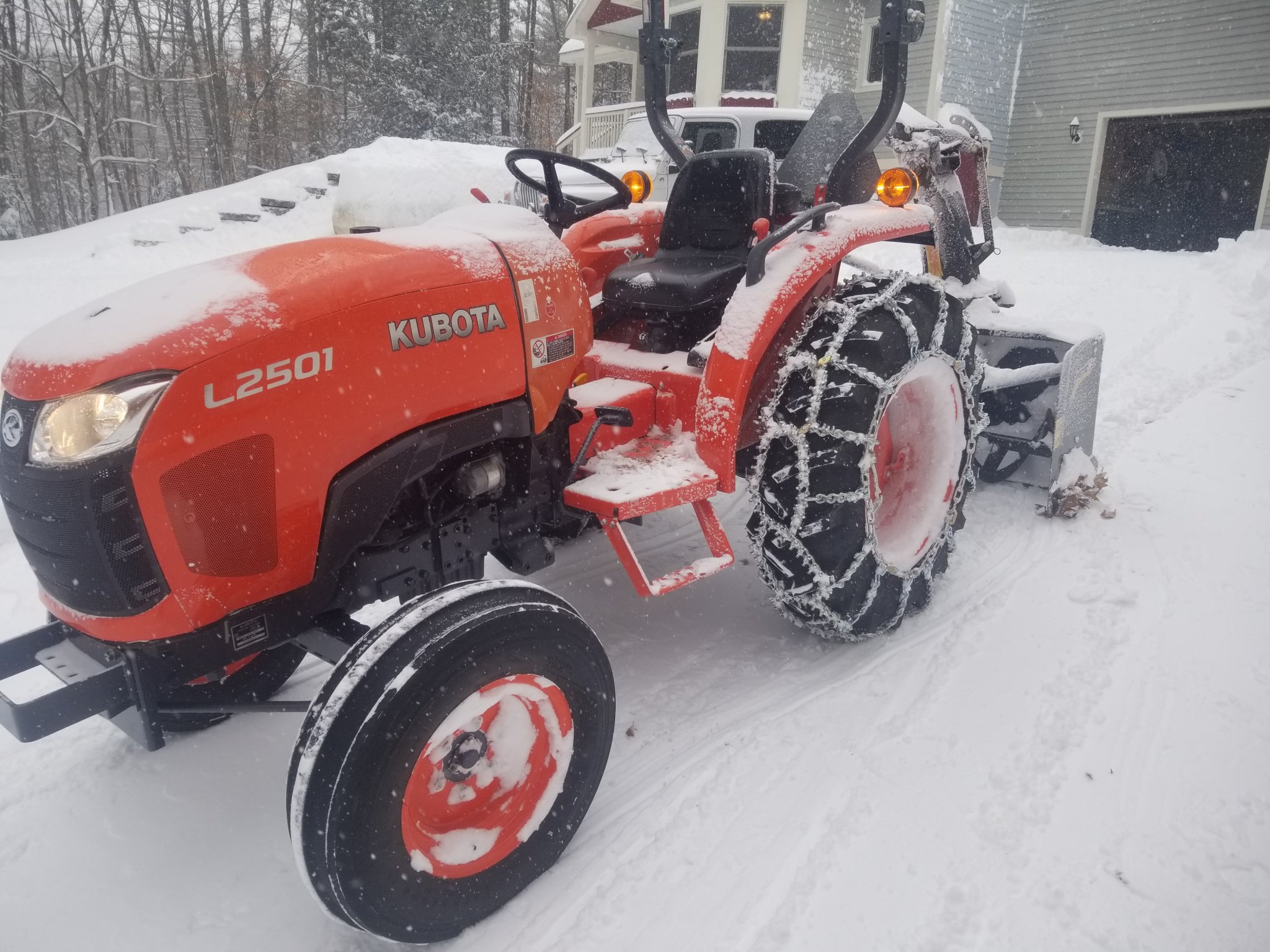

I got these from tirechains.com, they are diamond studded. My tractor is only 2wd with a pull type snowblower on a steep driveway. My tires are loaded and I can blow snow going uphill no problem with these chains. I've yet to even have to use the diff lock, the tires haven't slipped at all. Chains are worth every penny, buy the best you can afford and get studded no matter what. I haven't had any problems with studs causing damage on my asphalt driveway or my concrete garage floor.

Great traction chains but not at all suitable for pavement.

That’s not how they’re advertised ... my experience so far on asphalt driveway/road and concrete garage would appear to support the the advertising. I am concerned with the latest wet weather in the northeast, where we’ve lost most of our snow, of doing too much driving over over dry pavement with them or any any chains. Thinking of taking them off until the snow returns as Ive got ~ 20 rdtrps (5mi total) to pickup neighbors trees over asphalt ...

Taking chains off is easy, putting them back on is a royal Pain in the A**! I have very little pavement to drive on and leaving the chains on for the winter is no problem except the lousy ride I get. I hate the snow, ice and cold here and should move to Florida, but I hate Florida!
