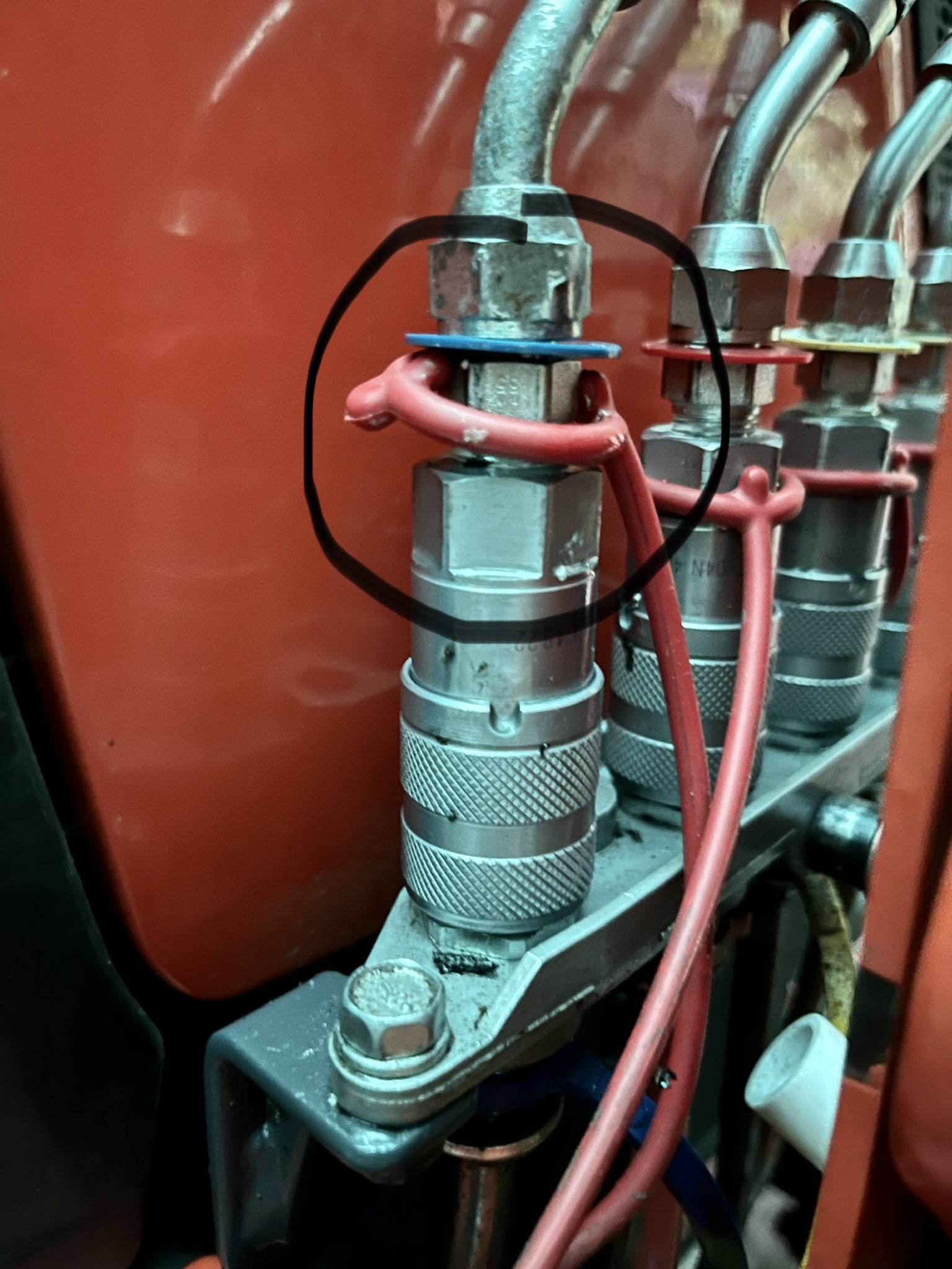

This is what I put on it. There are two connections that just screw together in the circled part. One of them, possibly both are leaking on all for lines.

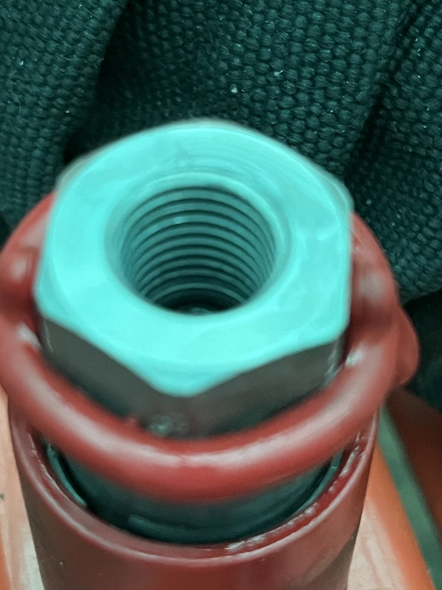

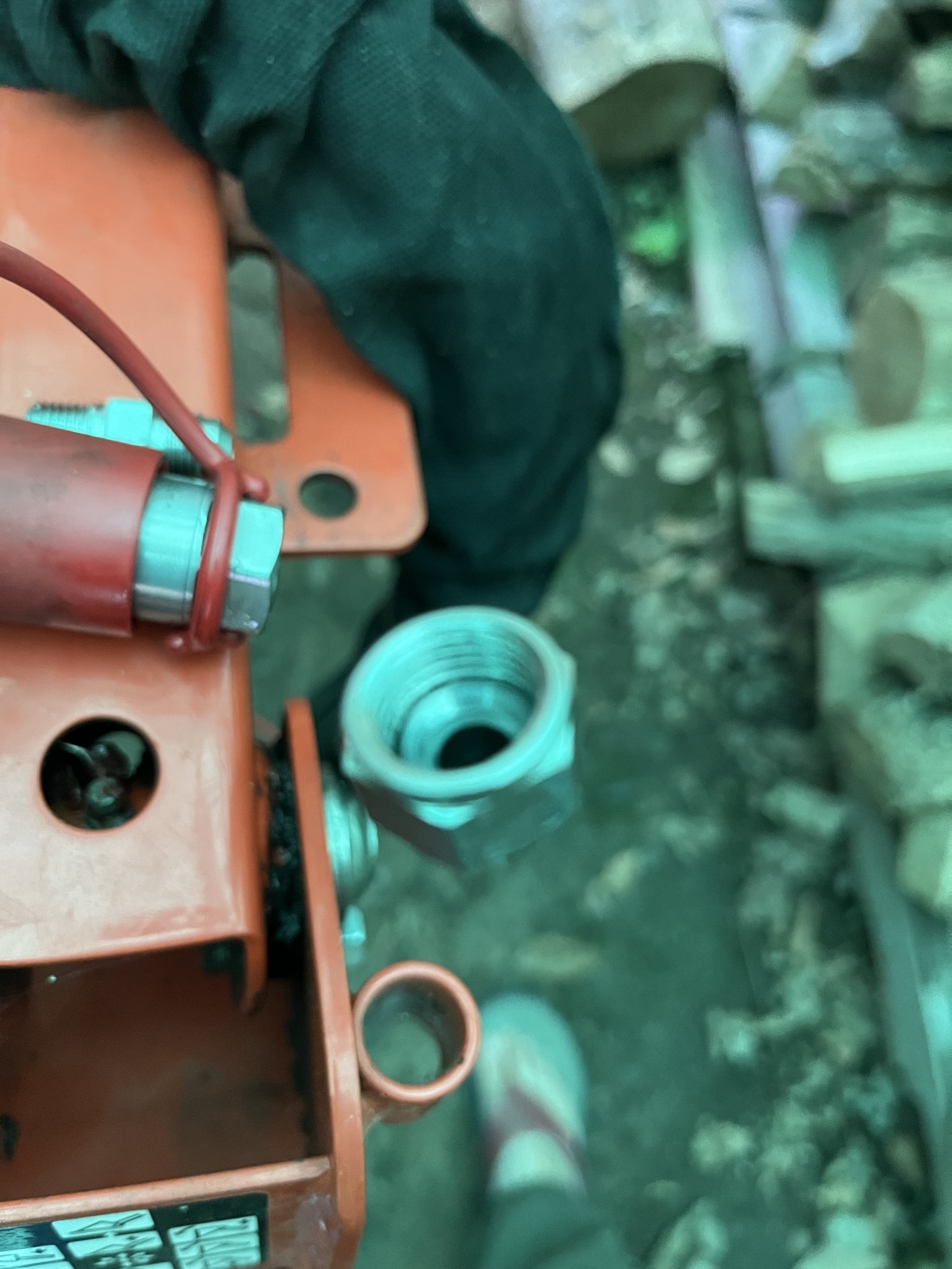

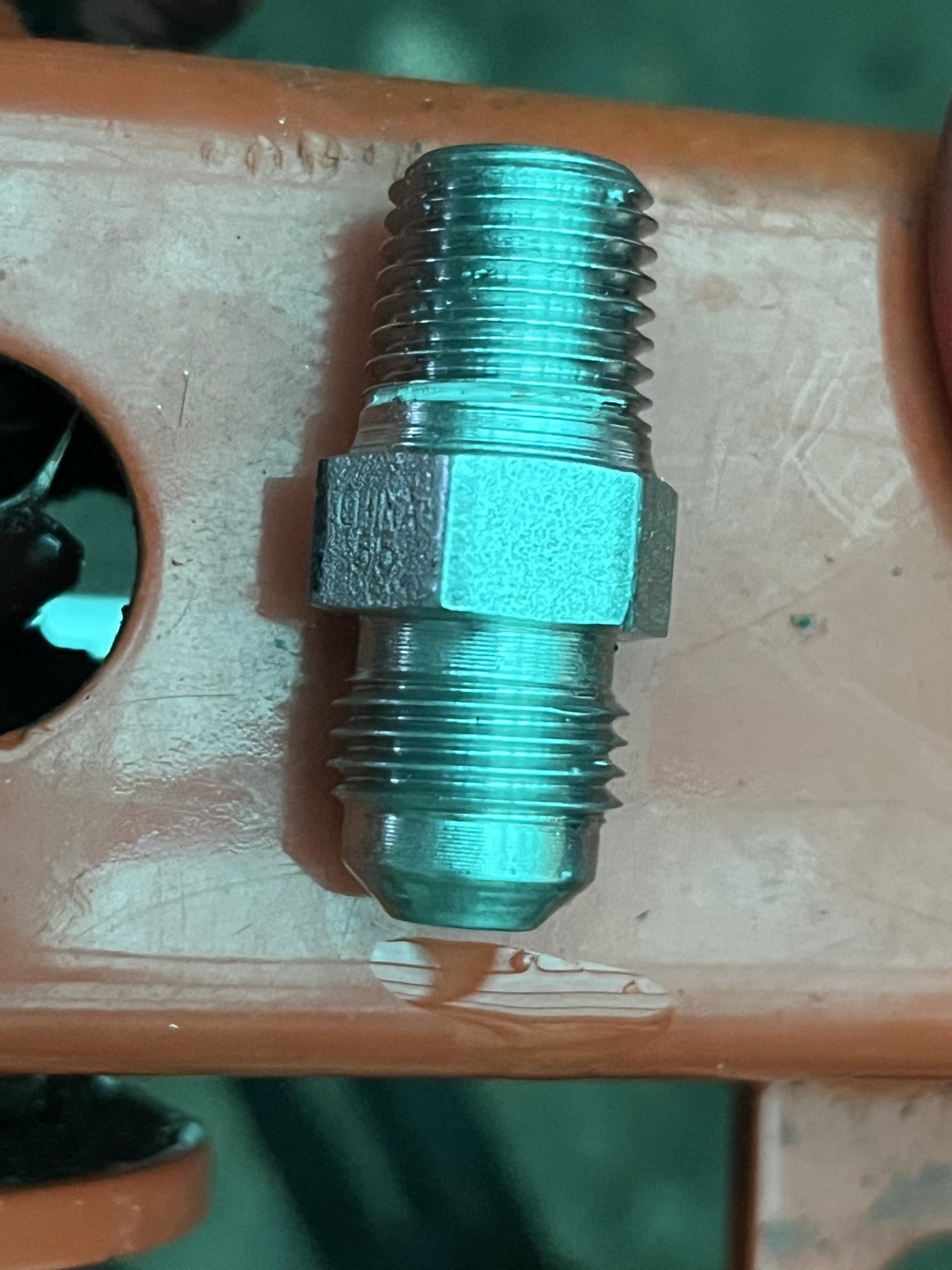

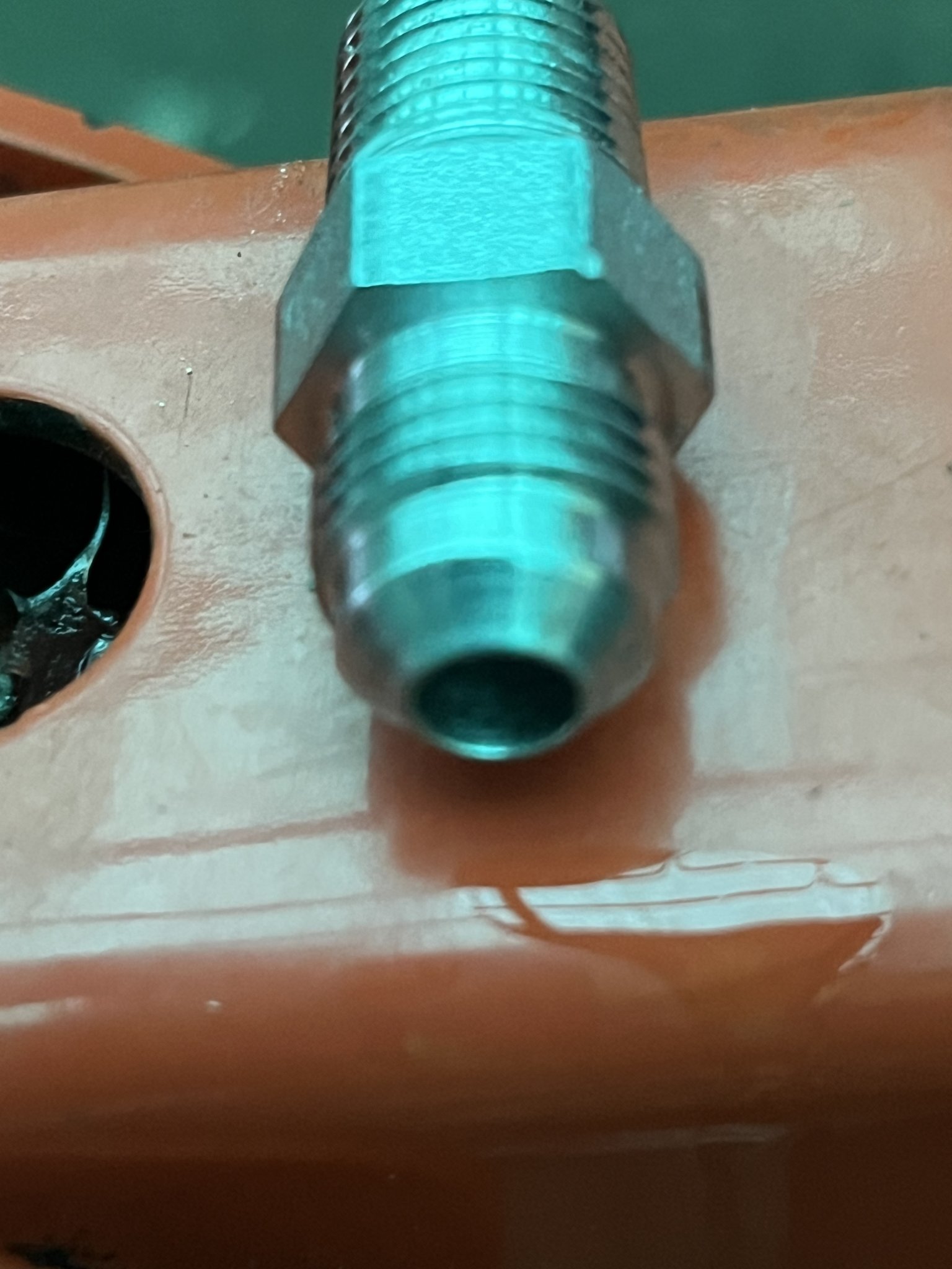

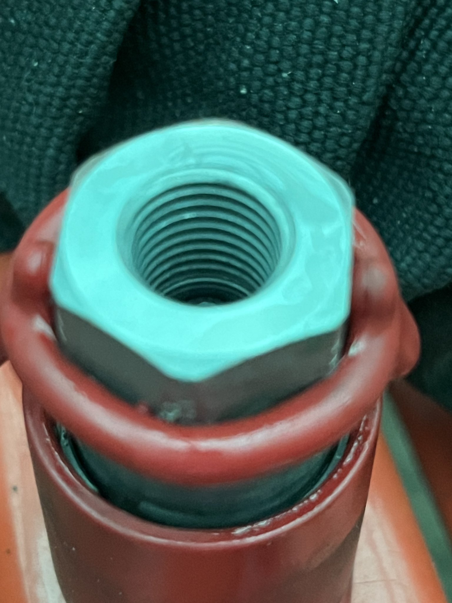

Take the fittings apart and post a picture of each end, I'm wondering if your putting 2 different fittings together.

Are you certain the male/male fitting has the right style compression fitting? I suspect the threads could be correct, but the tip might not fit the female side correctly? Just a WAG.

It looks the same. That is the fitting I read was needed on the website but I’m not 100% sure.

This is the fitting:
Fitting
It does say NPT.
Are you sure that would be wrong though? It threads in perfectly.
Plus, I can’t find a fitting with the same dimensions in EPT.
