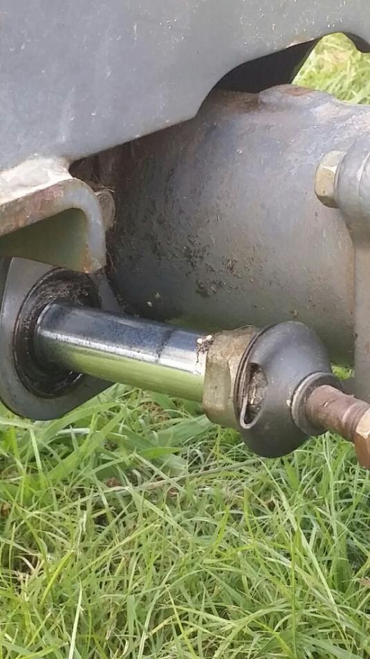

BX2200 power steering cylinder

Yep nothing real special via tools to fix it up. ;)

BUT drilling the ring is a pain in the butt. Get a nice bit and drill just to the front of the ring clip channel until it breaks through. I used a punch to move the ring... its a lot of force
FWIW i only removed one end as i could not get the other out.
