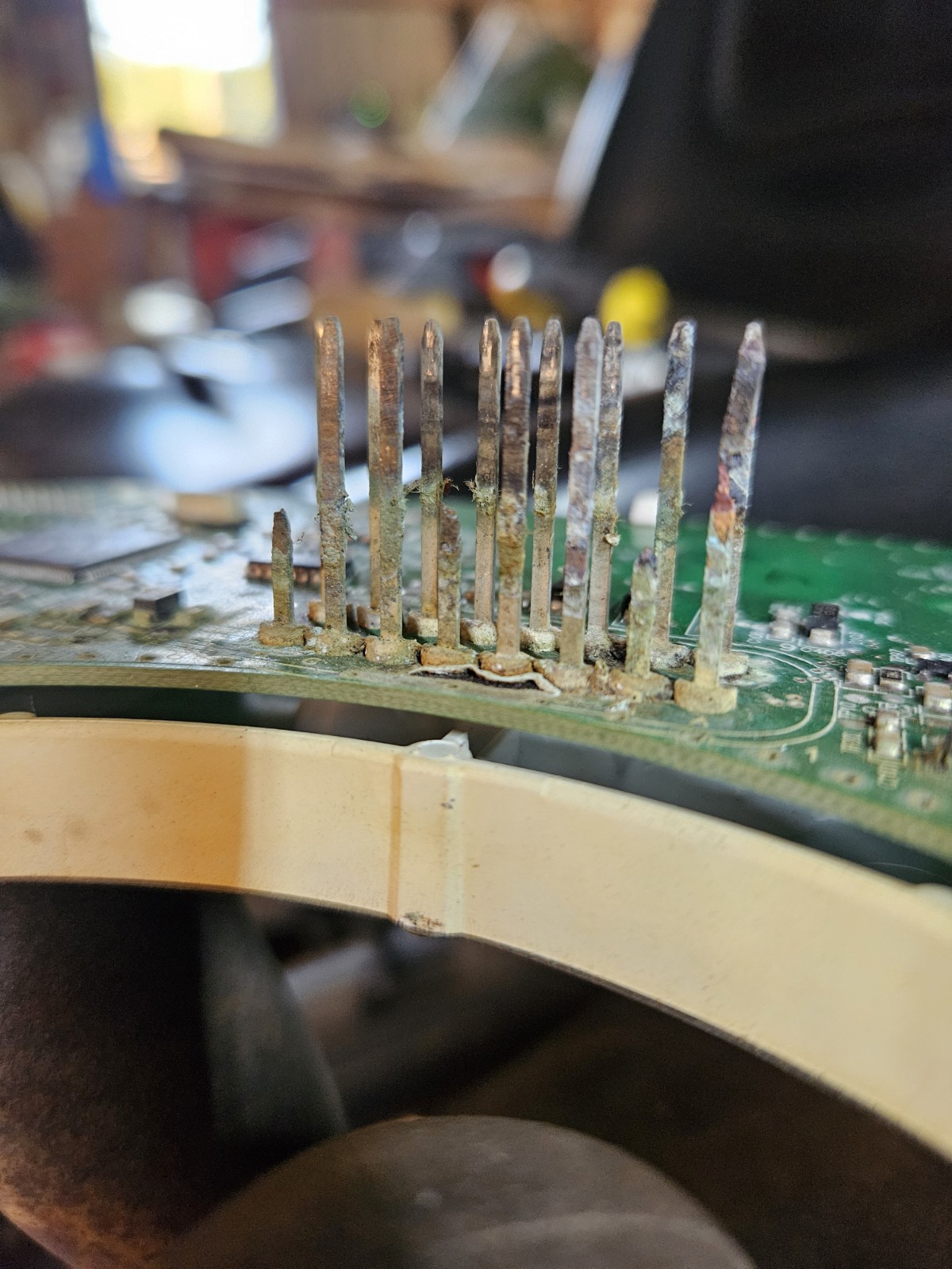

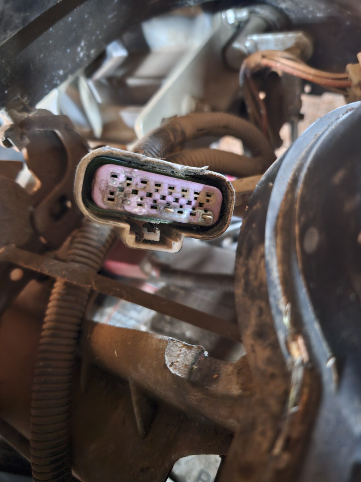

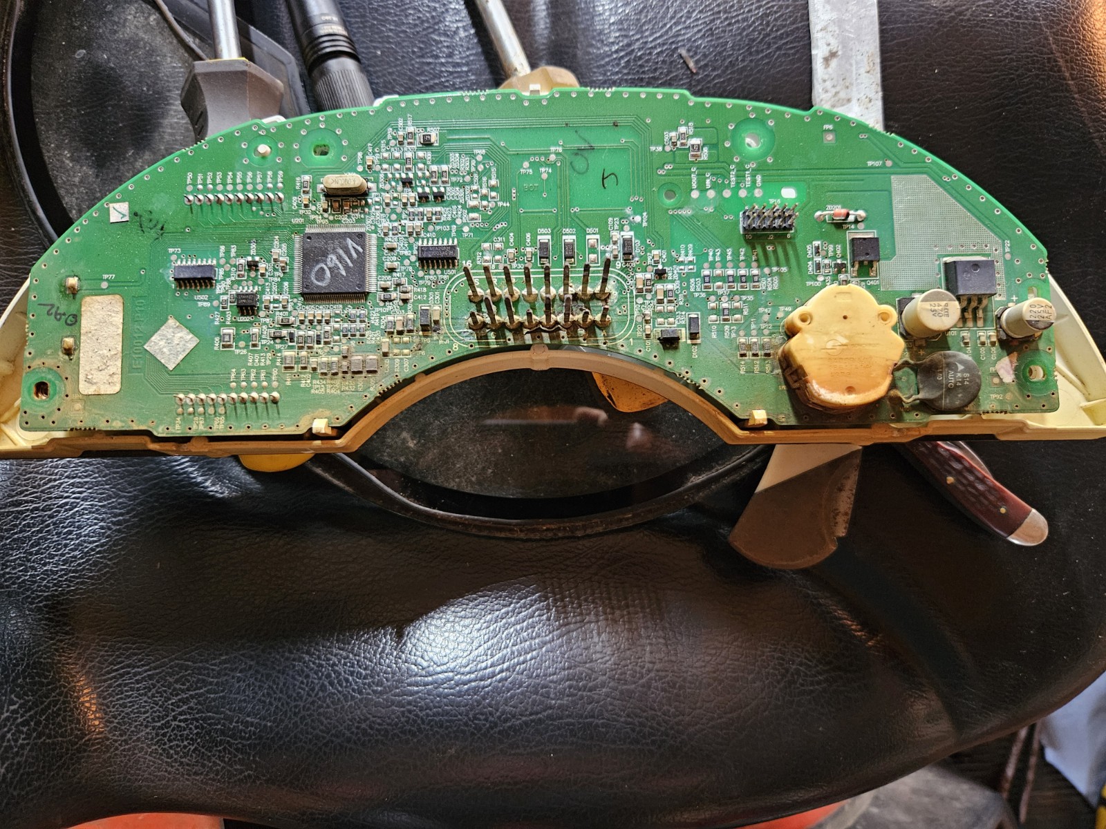

The non-working instrument panel. Got it removed without shattering housing or other.
Removed 16-pin connector. Trouble
Though difficult to see, multiple pin are broken due to corrosion and most others aren't far behind.
Not knowing what I'm doing, with key on, I tested for hot on a couple of pin receptacle's on the connector. Got nothing though the test was poor. Tomorrow I will stick pins / needles in those females and retest.
If it's only the 16 pins on the board, looks like a simple replacement for a good solderer. However, I can't separate the board from the "face" and those pins are inserted from that other side..
No way am I purchasing a new board.
I do want coolant temp, oil pressure, and preferably a tach. Prefer Kubota gauges from whatever / wherever but not required.
Hoping the rpm signal from the alternator is compatible with both the analog Kubota and aftermarket.
Located the coolant temp sending unit and idiot-light oil pressure sending units. From what I have read, Kubota and most other products of Japan use a mix of both NPT and BSP (Brit) threads. That can be dealt with in 3 different ways.
Considering fabbing an instrument panel, cutting holes for analog gauges, install, etc and be done with it. No experience with diesel anything and enough other to embarrass myself. I might also do an indicator light or 2 for glow plugs, etc. At a minimum, I must have water temp and oil pressure gauges.
Pics are difficult to see the missing / broken pins.
When you don't take care of your gear, this is exactly what happens. Today, I introduced it to the diesel supplement Howes. No idea if needed or not here in Alabama but it's so affordable and takes very little, I said what the heck.
Thoughts, suggestions, other are very welcome.
