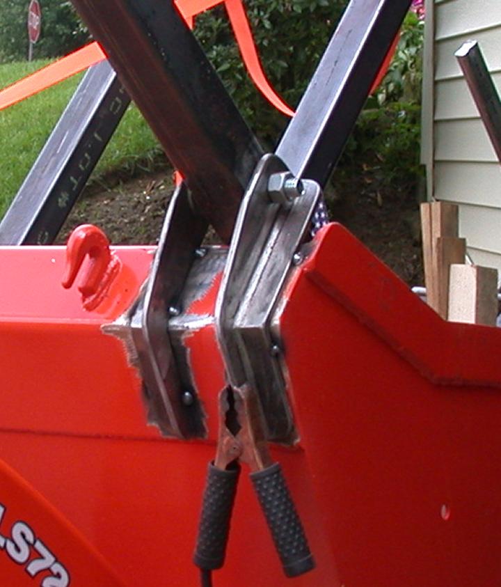

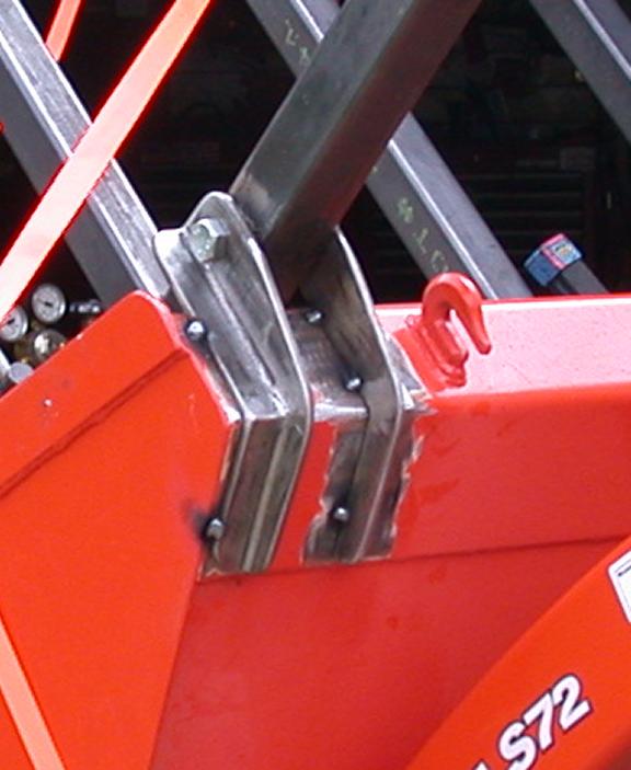

I made a set of light weight brush forks for the new loader. I did not want them to heavy so I made them out of 2"X2"X1/8" wall tubing. They attach with two cat0 5/8" pins, but I am making tabs to bolt to the bucket to keep them from pivoting out of the bucket.
