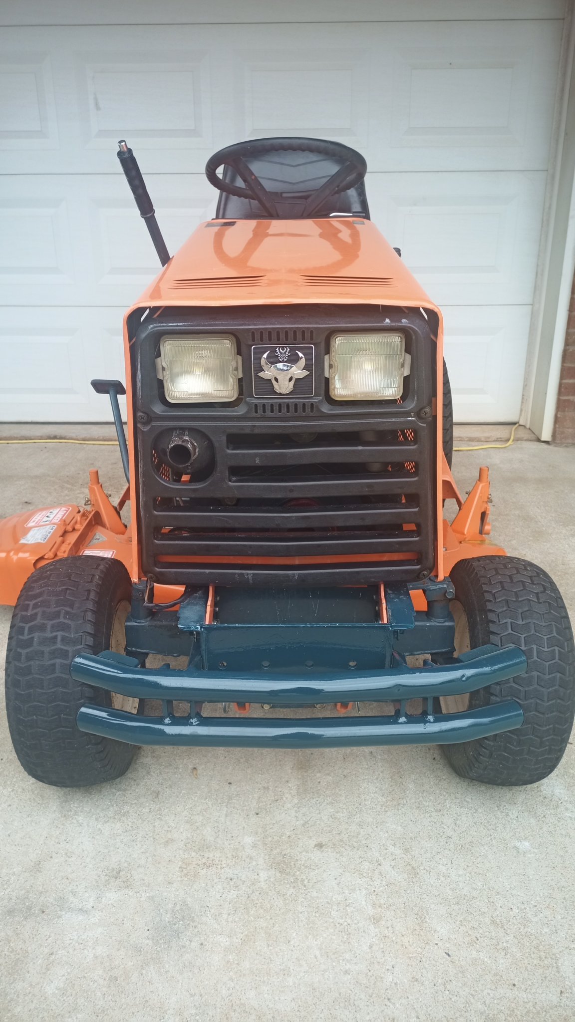

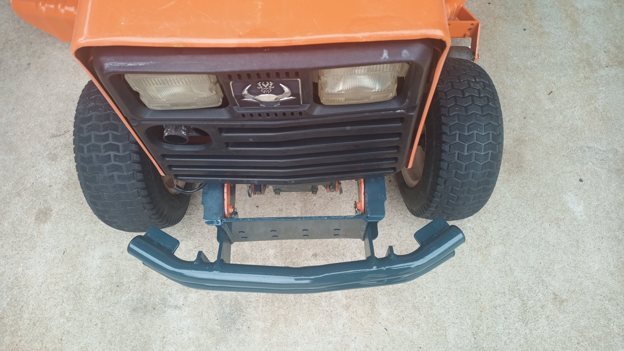

I had an unknown brand front bumper that I received with the purchase of another garden tractor several years ago. I knew I'd find a use for it, so I modified the mounts to fit my recently-acquired 1985 G5200H.
I moved the mount arms inboard, shortened them, and drilled them to fit pre-existing holes in the frame rails. I also added some tabs to allow me to mount some auxiliary lights. Finished it in Kubota blue-green paint to match.

Looks good! You never know when you will find a use for some odd piece you have laying around.

Brilliant idea!
Maybe from a Craftsman mower?
Perhaps, as they have offered dual bar bumpers for different models. I got it with the purchase of an old (pre MTD) Troy Bilt tractor, which the PO was going to fit to it but never did.
