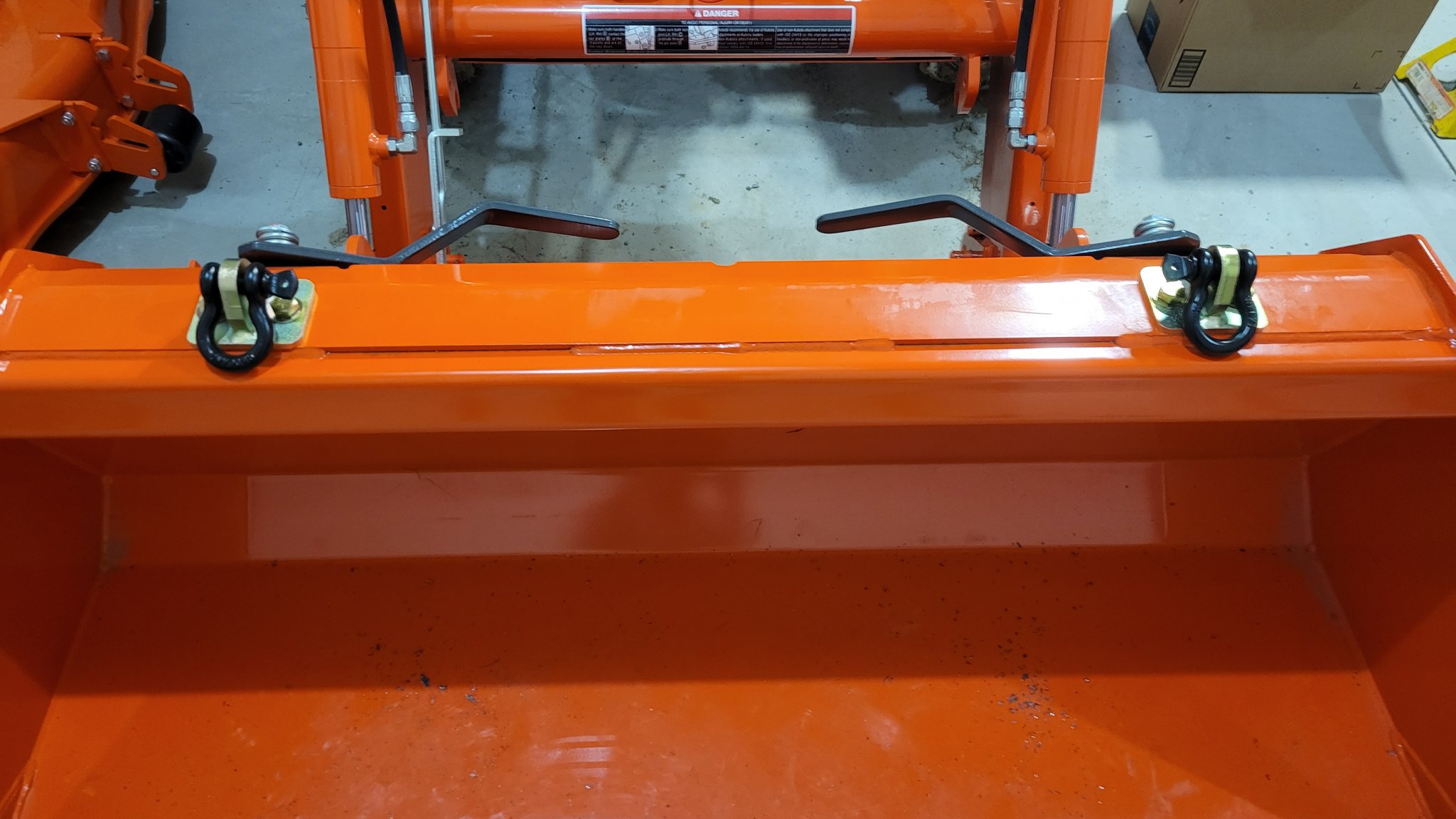

I don't know about the model you have listed from Amazon, I can tell you I have Ken's Bolt on Hooks and they work great! A can of spray paint and they matched my tractor.

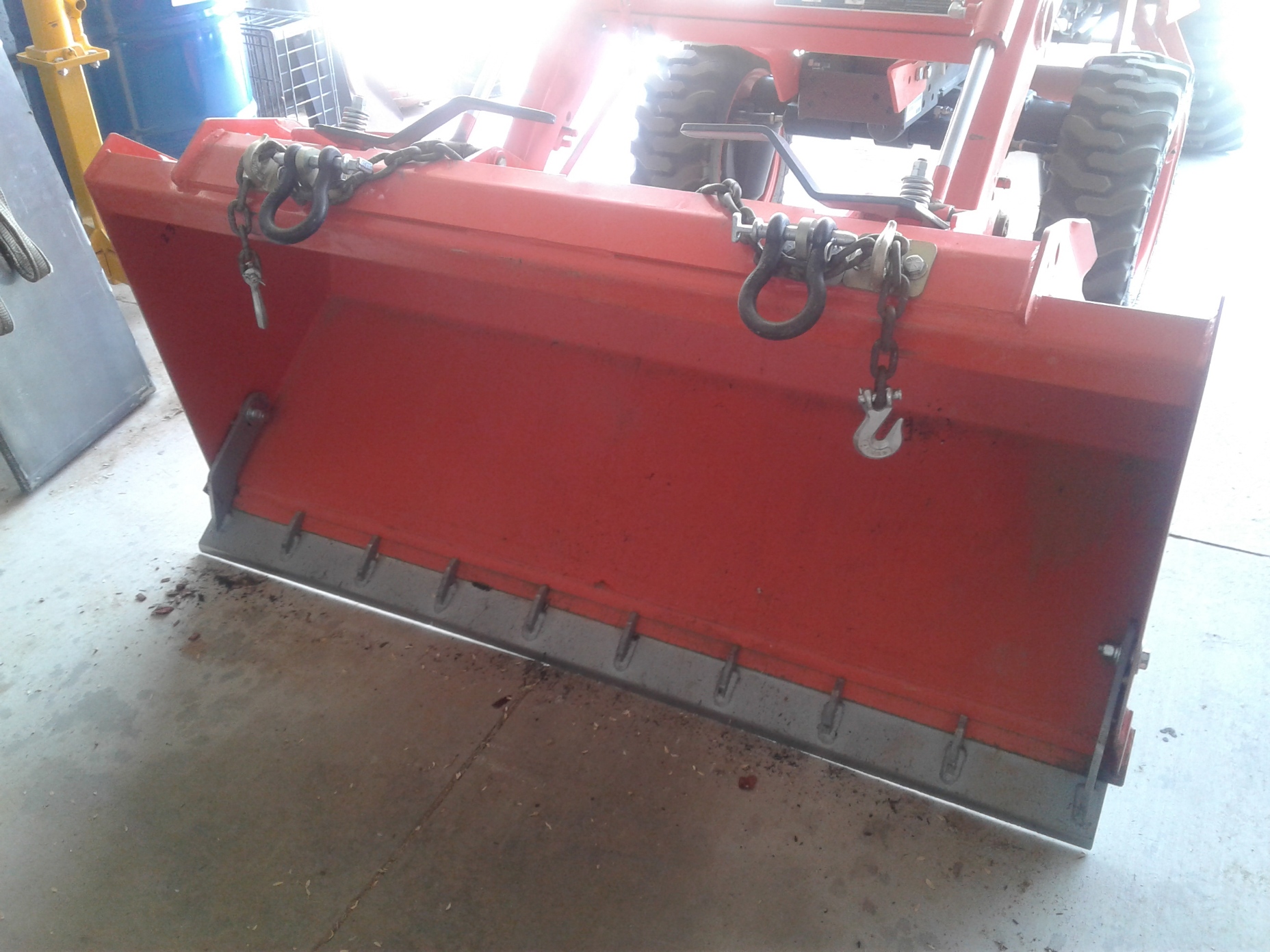

I am very pleased with mine being attached to the bucket corners with grade 8 bolts and 3 links of grade 70 chain. The chain allows some pivoting action.
