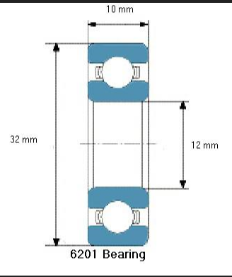

Kubota part number 1553174180, shown as CDN$11 on the website. But I bet it is a commercially available bearing. Check for a number on the bearing itself when you get it apart.
10,917
2,737
$3.50 each at Princess Auto....
yeah - I was shocked when 2 of them cost be like 8 bucks .......... not that 4 bucks a bearing was cheap, but ol - 8 bucks and I get this thing spinning again........ o hell yeah.
this is how I knew my bearings were bad ............ talk about balls missing ......

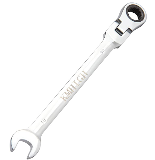

you need either a modified 10mm open wrench or ......... the best solution is a 5 degree or a 3 degree swivel head ratcheting wrench.
this will take the nut off ............. easy peasy .............
now getting that little beeaaauch BACK on ................ will make you invent cuss words!!!

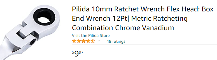

Have you tried a ratchet 5 degree - flex head? It is 10 bucks on amazon and worth every penny!!!!!!

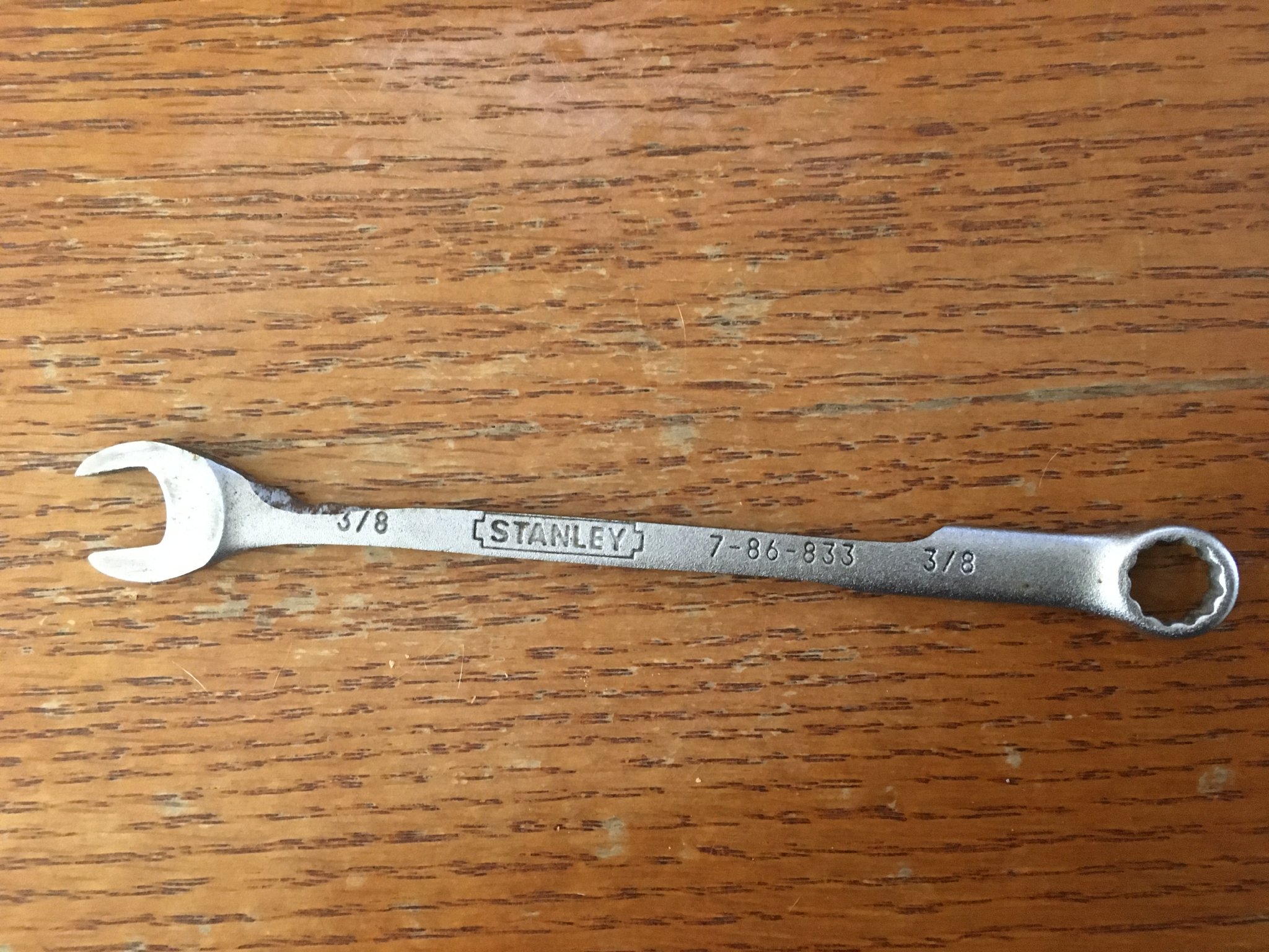

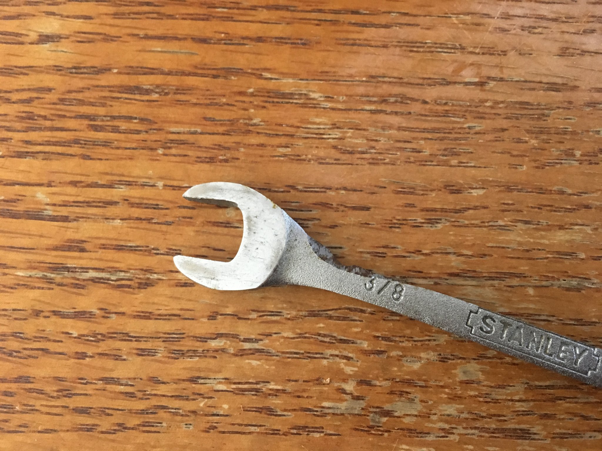

Thanks for the link and your technique of getting the nut started and back on! When I did mine on my B7100 after the required amount of cussing :LOL: I sacrificed a cheap 3/8 combination wrench. I had to open up to 10mm, and after grinding half of the wrench away I got the job done. I think I will pick up the 10mm ratchet wrench you linked to , just in case I have to do that job again. :)
