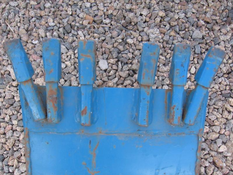

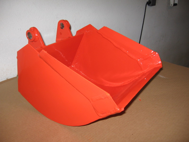

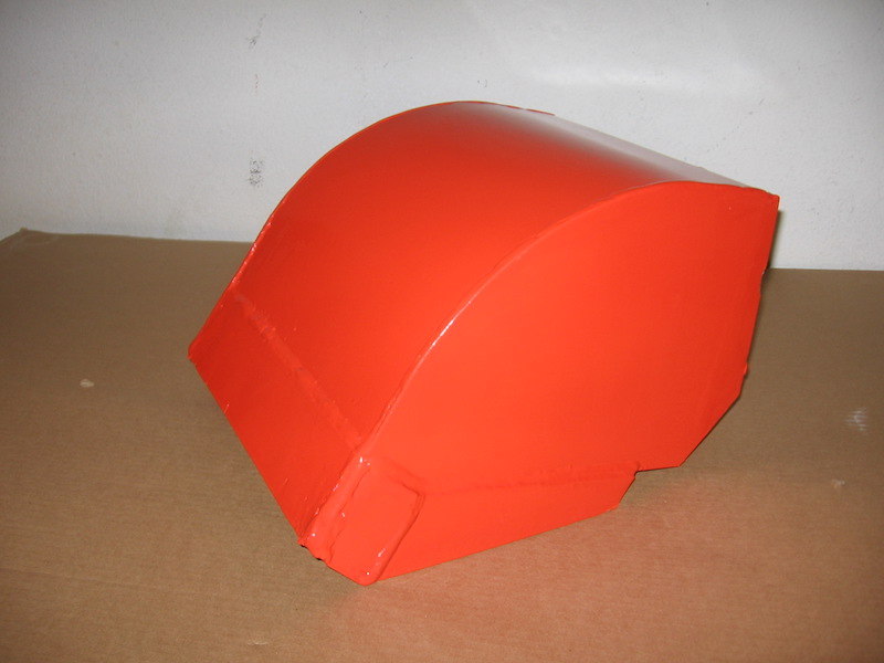

Anyway, I bought the blue one and it IS a Kubota B670 bucket. The "ears" have an extra boss added, (more surface area?) but otherwise it is identical to my current 14".
I am at a loss to explain the blue paint, or the oddly spaced, slightly crooked teeth. As soon as I get time, I will cut the teeth off with the mill, maybe maybe throw some orange paint on it.
Anybody need some teeth?:D
1st pic is the two buckets at the dealer, 2nd is my two, 3rd & 4th are the new bucket.

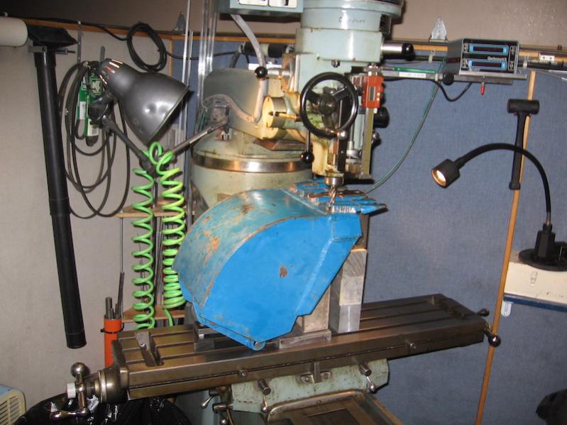

Began cutting welds today. A little touch up with a cutoff wheel on the peanut grinder, and then we will find out how much penetration the welder got.
Sean, any part of that setup look familiar?:D
7,281
2,234
The answer is A LOT. These were the toughest welds I've ever dealt with. Judging by the mangled cutting edges on three cold chisels & the destroyed roughing end mill, at least some of this welding must have been with a hard facing rod.
Anyway, bucket has just been primed, hopefully I will "orange it up" tomorrow.
I have no use for the teeth, so if anyone has a project that might require a little extra bite, you can have them for shipping costs. All need some clean up with the peanut grinder, 2 are virtually perfect, two kinda chewed, the other 2 somewhere in between. I will also put an ad in the classified section. PM me if interested.

Like your setup on the mill! I do the same thing on mine. I like to say that there is no rules when it comes to setups on mills.
As far as the welds being hard, it could have been hard facing rod but more likely the alloy from the teeth melted into the welds. Did they cut harder the deeper you went?
7,281
2,234
On the ones I had the most trouble with, yes. But three of them weren't bad at all. You're probably right, probably a function of how hot/how deep that particular bead was.

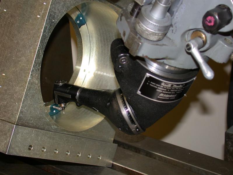

I've done some truly bizarre mill setups over the years, but the coolest ones I have no pics of- they were confiscated when I retired. Nothing secret about the setups, but what I was working on was "not for public consumption".
Extra points if you can spot why work has halted, giving me time to shoot these pics.:)

What is that attachment? That is the coolest thing I've seen in a while. And it doesn't look cheap.
7,281
2,234
Bridgeport QuillMaster attachment, with 90 degree attachment. Incredibly versatile, and incredibly expensive. I think I bought that one (with the company's money) for nearly $5K. One of the coolest jobs I did with it was to reach inside a 3" dia "pipe" and mill two "T" shaped pockets vertically opposite from each other.
I have seen them used in the 2.5K range, but I just can't justify owning one.

If I come across one I'm not sure I have the discipline to resist. What kind of collet does it have?
7,281
2,234

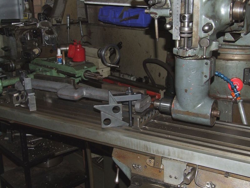

I think the collet is specific to the quillmaster, I don't think any standard collets will fit. Someone in my shop lost a collet, (vacuumed it up I think) so I bought a replacement, & it was over $200.:eek:
What I would love to have & would get a lot more use from is the standard Right Angle Head, & H-Mill Arbor Attachment. Uses R8 collets. Really handy!
Note; there are also a couple of smaller right angle attachments out there that don't work with the H-mill arbor. (last pic)

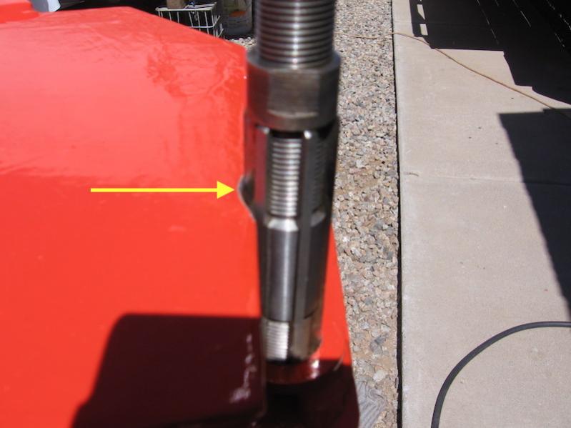

When I measured the bucket mounting holes & spacing, I noticed the 1" pin holes were very tight; some rust, blue paint, & a few dings. I decided to ream the holes after painting, with the old Critchley adjustable reamer.
While I was cutting the teeth off, I noticed, as far as I could tell, this bucket had never been in the ground.:eek: I think I know why now.
I reamed the holes closest to the open side, no problem. When I attempted to ream the other holes, I found that the side plates of the bucket extend too far, blocking the 1" pins from going into the holes. Absolutely no way, almost .100 interference. So, out comes the die grinder, cut some clearance, and then reamed the holes. A little paint touch up and I'll be ready to start scraping off all that beautiful new finish.
