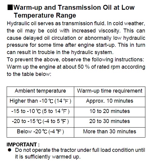

You need to be following Kubota's recommended warming procedure if you want to avoid expensive damage.
Just because the engine starts does not mean the tractor is ready for use.
Dave

Thanks Dave,
I do normally let it run when cold for 20 min to half hr anyway but it concerned me that the 3pt hitch wasn't coming up when I started it like it normally does and didn't want something trying to working it isn't working. If that makes sense and yesterday was kinda in s rush got home and needed to lift bucket to get something I parked to close to. (Tight quarters) and that was my concern. But I do understand that Equipment and diesels need warm up times. But great point I appreciate the reminders. Cause we all do get complacent too.
