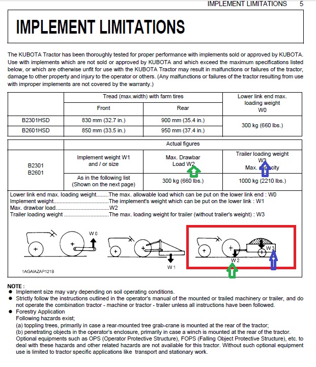

Start by referring to the following page in the Owners' manual for your tractor.
This info below is not your tractor!
Read the page carefully as W3 is weight added to trailer and does not include the weight of the trailer itself.
If you are going to be operating in hilly terrain as you mention, then putting electric brakes on the trailer would be wise.
