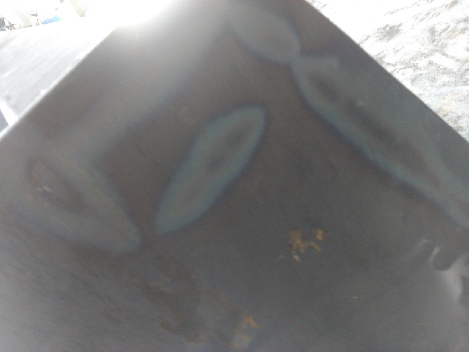

Those are pretty sweet. How do they mount?
Not trying to hijack zappers post, but I had some pics readily available to post so easy to show you. There are 2 existing holes in the loader frame that are unique to the LA534 loader. I made a jig up to weld grade 8 bolts to the toolbox to use those holes to mount the tool box. It worked out well and is very secure.
