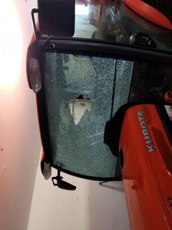

I cleared the snow from my driveway the other night after work and put the tractor back into the garage. No issues during the job nothing hit the windshield and it wasn't particularly cold. The garage is unheated but generally stays around -2 or -3 C(27 to 30 F)
The next day I went to start the tractor to finish clearing the drive and take care of the neighbors and found the front windshield totally spider webbed, see attached pictures. The hole in windshield happened when I closed the door Has anybody ever had this happen?
Any thoughts would be appreciated.

Not in a Kubota, but in other brand tractors and construction equipment. My wife’s Dodge Durango rear window did that last winter. Shut the door and the rear window blew out.

Did that to my M9 cab traxtor years ago, closed the door and blam, it exploded. Had a small pinch bar sticking out on the floor and when I closed the door, it hit the bar and that was that.
Replaceable, you bet. Cheap, not hardly. Almost 1000 bucks US for the door. I suspect your side pane will be a lot less and I'd check with your insurabce carrier, most cover glass like that.
I carry a $1000.00 deductible so I ate the cost and I'm very careful now.
Good news is you can do it yourself (install). Will be a dealer only item

Any type of defect in the glass can cause this to happen. Could have been something that happened months ago and with the additional stress caused by temperature changes exceeded the limit.
You're lucky the cost is reasonable.

I have a new windshield on order here should be in tomorrow $413 with tax plus installation.
I was kind of thinking it would be some kind of overpressure when i closed the door but wasn't sure, guess i'll have to make sure to close it gently from now on.

Both tempered doors failures were caused by spherical NiS contaminant particles. One particle has a diameter of 180 microns. The other particle has a 100 micron diameter. In addition, both particles were centered 2.3 mm from the edge of the glass. This failure mechanism is well known and has been previously documented. The NiS particle forms during glass manufacturing. It is created by contamination in the fuel (S) and nickel from tools used to handle the hot glass. Initially it is one crystal structure; however, over time it will change to a less dense crystal structure that creates local stresses and cracking. The rate of occurrence varies with respect to the manufacturer. NiS contaminants are said to be a problem with fully tempered glass
NiS stands for: A nickel sulfide inclusion, occuring during the process of manufacturing glass

That is the second B2650 windshield Ive seen spiderweb like that. The first was also on this site, stored outdoors. Guy thought it was morning dew on glass but it was completely cracked like yours. Im sure thermal dynamics is playing a role in this...

For your sake and mine ( and my wallet) I certainly hope it don't. The little glass 'pebbles' went everywhere in my cab, under the air rise seat frame, under the floor mat, every crack had glass pebbles.
I see there is replacemebt glass on Flea Bay now but I'd be very cautious about buying it. It has to fit just so in the gaskets or it will shatter immediately. Like a car windshield, it has to 'float' or it shatters.

So the installation cost me 670 including tax, the brings the total for the windshield replacement to almost 1100.:eek:
