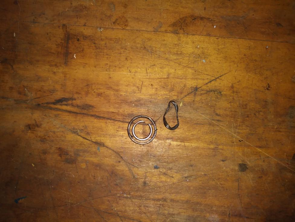

About a year ago I tore into why my HSD creeped when the peddle was released. Found out it was a bearing that rode the shifting cam. The little bearing was about the diameter of a quarter and three quarters thick. The Kubota costs for the bearing was $19.
I fixed myself... I put a post on this site complete with pics if you are interested.On my B2410 the fix was simple... but getting to it was a bitch...
I just saw PH Paul's WSM picture ... look at (2) that is the bearing I was talking about... my throttle is perfect now... good luck!

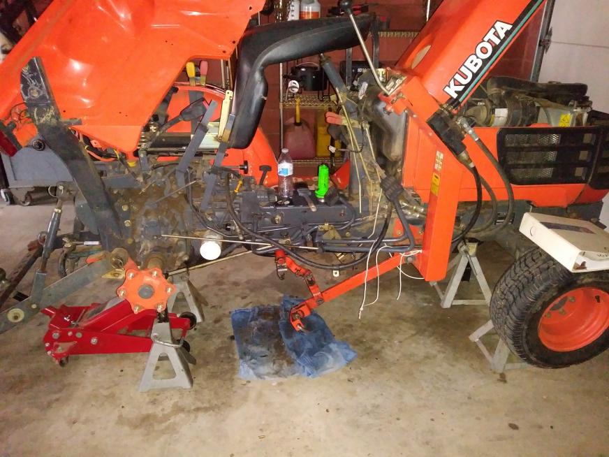

PHPaul... here are a few pics of replacing the little 20171206_100844.jpg quarter size bearing... about 5 hours tear down and six hours reassembly... still trying to figure out if the site allows me to see all my threads
Butch
Kubota 2410, RC60-24B, FL1000- kubota hydrolic front snow blade- plug aerator
Sep 10, 2009
680
152
75
Rising Sun, MD
PHPaul... here are a few pics of replacing the little View attachment 37712 quarter size bearing... about 5 hours tear down and six hours reassembly... still trying to figure out if the site allows me to see all my threads
Take a look at the tear down picture... zoom in on the water bottle and just below it you can see the newly installed bearing... Normally you would have to split the tractor to access it,,, even though you can see 2/3's of it... I used a small hole saw to to cut a 1/2 moon allowing access to the bearing... used a dremal tool with small grinder to pop the inner race (Harbor Freight) ... it slid right off with needle nose pliars
