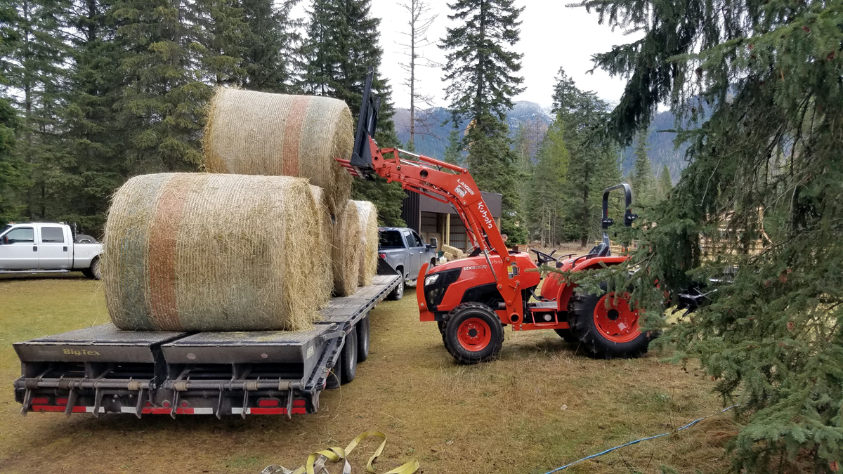

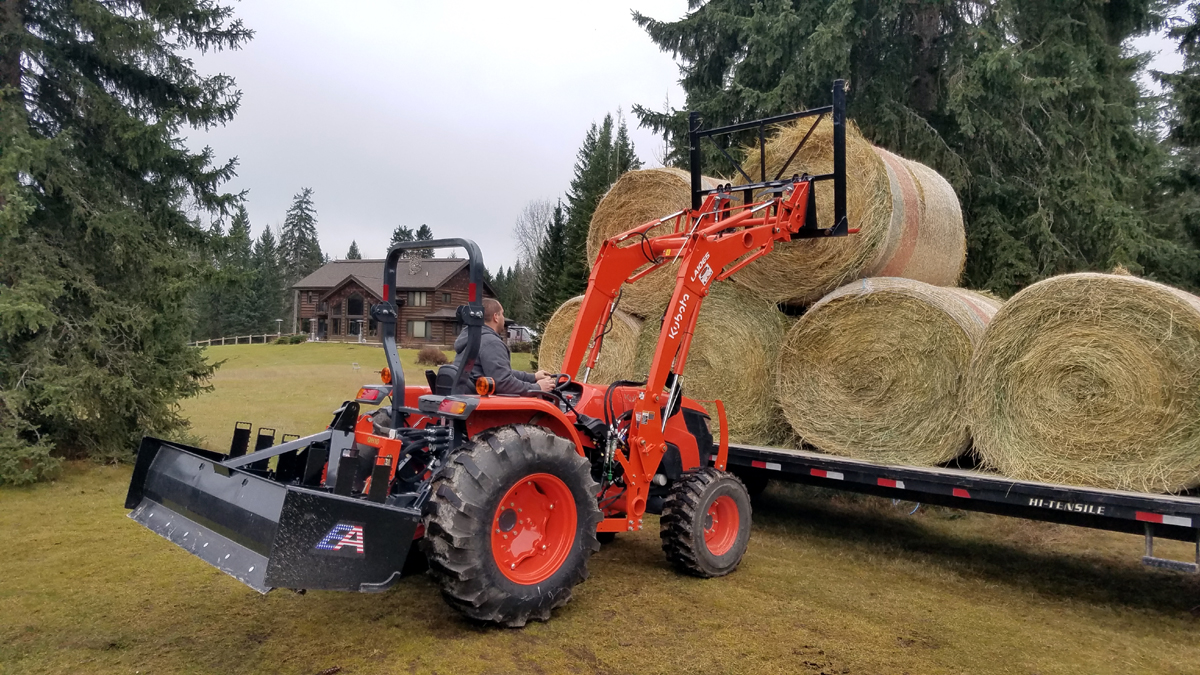

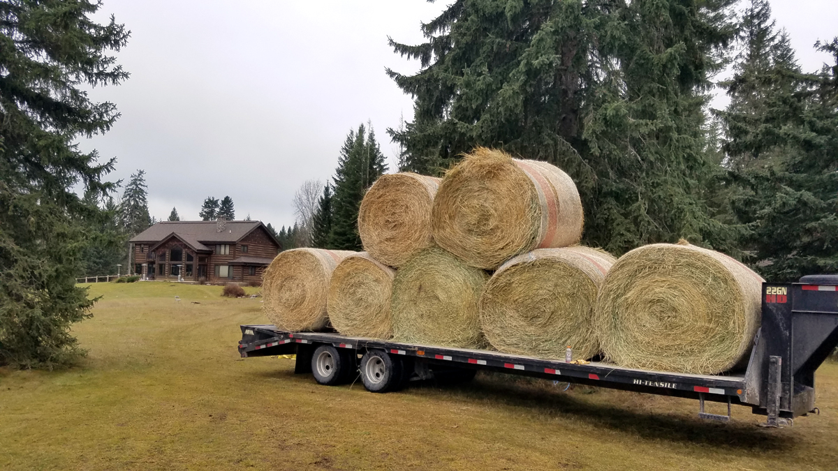

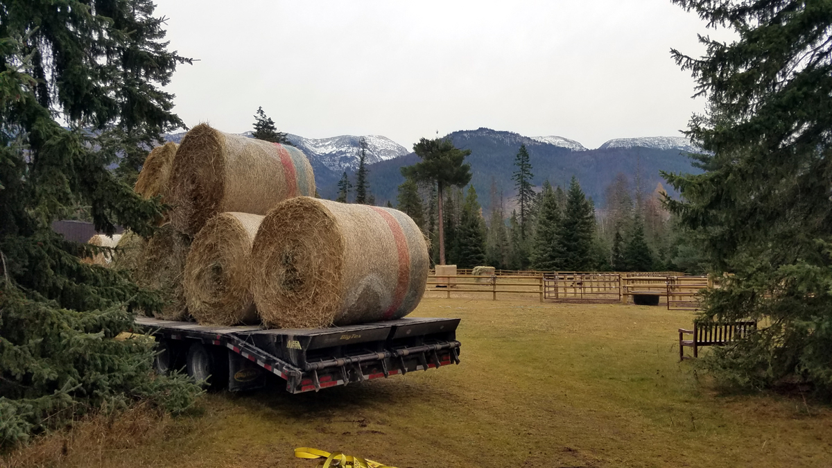

I got off to a bit of a late start this morning but did manage to get over to my friend's place and unload the first trailer, then go with him to pick up more bales, and he unloaded the second trailer. He's keeping the tractor overnight since he needs to pick up five more bales tomorrow morning. It was very dry in MT this summer and hay production suffered so bales were trucked in from Wyoming. I think my friend mentioned paying $250/ton from an individual that raises longhorns. He was the one that had a lot of hay trucked up to the Flathead Valley.
These bales were 6 ft in diameter and about 5-1/2 ft tall and they were HEAVY! 1,400 lb was mentioned and the bales make the MX look small. You can see from the photo that the bales on the top row were at about max FEL height for a center spike. To be honest, there wasn't enough roll back force to rotate the bale off the stack when removing the top bales. Also, I could have used another 600lb or more out back.

Thanks for the clarification. 😊 Technically the bales are 5'x6' then which would make sense given the supposed weight of 1,400 lb.
The shed they had built for square bales isn't ideal but it'll have to do. They're having a steel building put up next year big enough for kids to do barrel racing and enough storage for all manner of things including hay.
Thanks for the advice. We were able to get it done without any drama, in large part due to the advice offered in this thread. It's much appreciated.
