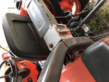

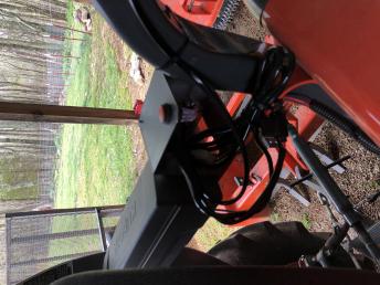

I made an LED light bar and attached it with U bolts from Lowe’s, cost about $2.50 each. Fit perfectly around the ROPS.
I initially used aluminum angle, but it would vibrate a bit, so I swapped it out for a steel 1.5” angle. That was about $15. I bought a pair of 12” LEDS on eBay for $22, and a pre made wiring harness for another $9.
I had a piece of angle aluminum that I mounted to the warning triangle mount and placed the ON/OFF switch and relay there.
I just used tie wraps to bundle up the excess wiring and ran the POS and NEG up to the battery inside of conduit and used a set of battery clamps so that I can disconnect when not in use.
I mounted both sets on the horizontal, but may move the light pointed rearward to the vertical so I can point the light down farther to get more light on the 3 point area.
