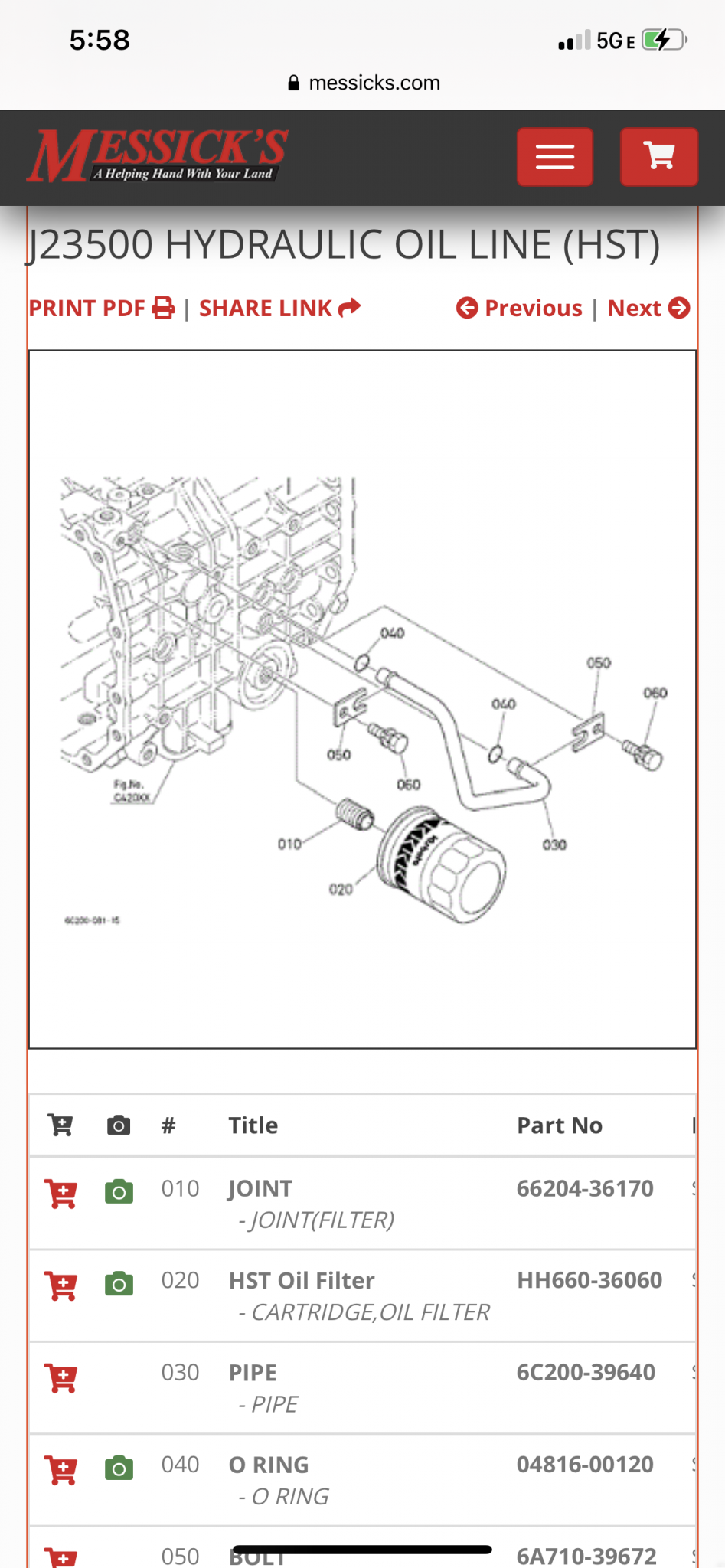

Guys I just did a 50-hour today on my LX3310.
Something weird though and I triple-checked everything. I removed the transmission filter and the hydraulic filter but the new ones would not screw on unless I swapped them. The hydraulic filter only screwed into the transmission and the transmission filter would only screw into the hydraulic.
Double-checked part numbers and everything. Is perhaps the manual mistaken? It must be my error but the two filters have different type ends for mating.
Thanks for the help.
I don’t know the tractor….
From parts diagram it appears the hydraulic filter is on the right side of the tractor (while sitting in seat facing forward) and the HST filter is on the left side of the tractor.
not sure if this helps any 🤷‍♂️
