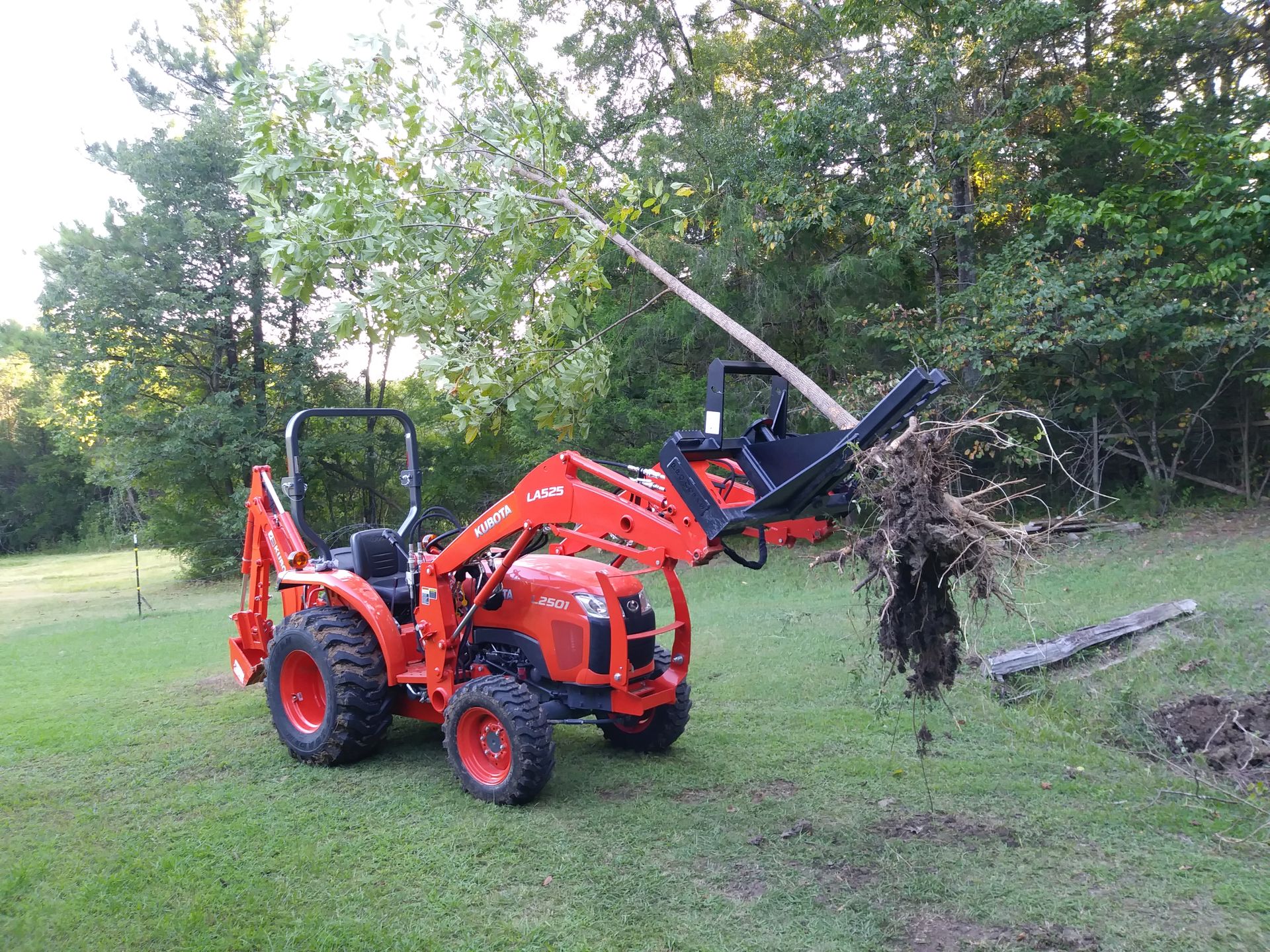

i have a l2501 with grapple And sandy soil. I can easily just go up to a tree, raise the grapple to about mid loader height and push the tree over. Then I come in from the side with the grapple, grab the tree close to the roots and use the roll function and most times the roots will pop out. This works on trees up to four inches and I have used the same technique on much larger red and scot pines. Of course they do not have a tap root to speak of. And if I had heavy clay soils I would have a problem. You might be pleasantly surprised if you try this method .

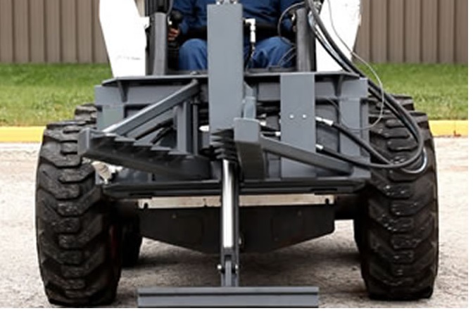

There are some tree puller designs that use a vertical hydraulic cylinder to push against the ground to pull the tree. The 3pt hitch or loader just has to carry it around.

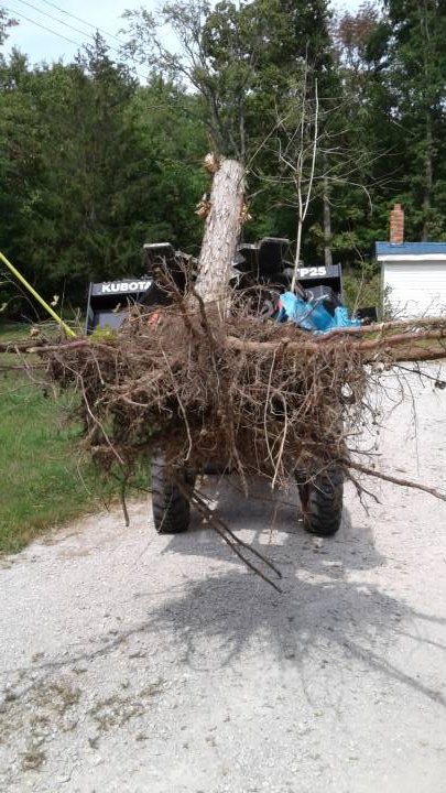

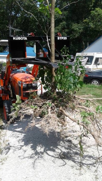

I bought one that goes on my loader. I don't use it that much, but I don't regret the purchase. My machine will not pull up a big tree. The tree in the picture is about as big as it will pull on my property (too big actually) and the soil must be wet. That one was growing along a wet ditch. Cedar trees bigger than that will come up easy since they have little root structure. But, the tractor can pull up smaller ones OK without making much of a mess, compared to digging a tree up. The soil dryness and type of tree will be big factors on how easy pulling a tree is, including soil type. Being bigger, your tractor will be able to do more than mine. I can actually do better on bigger trees simply pushing them over with the grapple like already mentioned by Ken above, and once pushed over, working it back and forth until it breaks free, sort of like bending a paper clip back and forth until it snaps.
If I pull several with it, I just leave them there to rot or place them in a pile using the puller and then gather the pile up later with my grapple.
