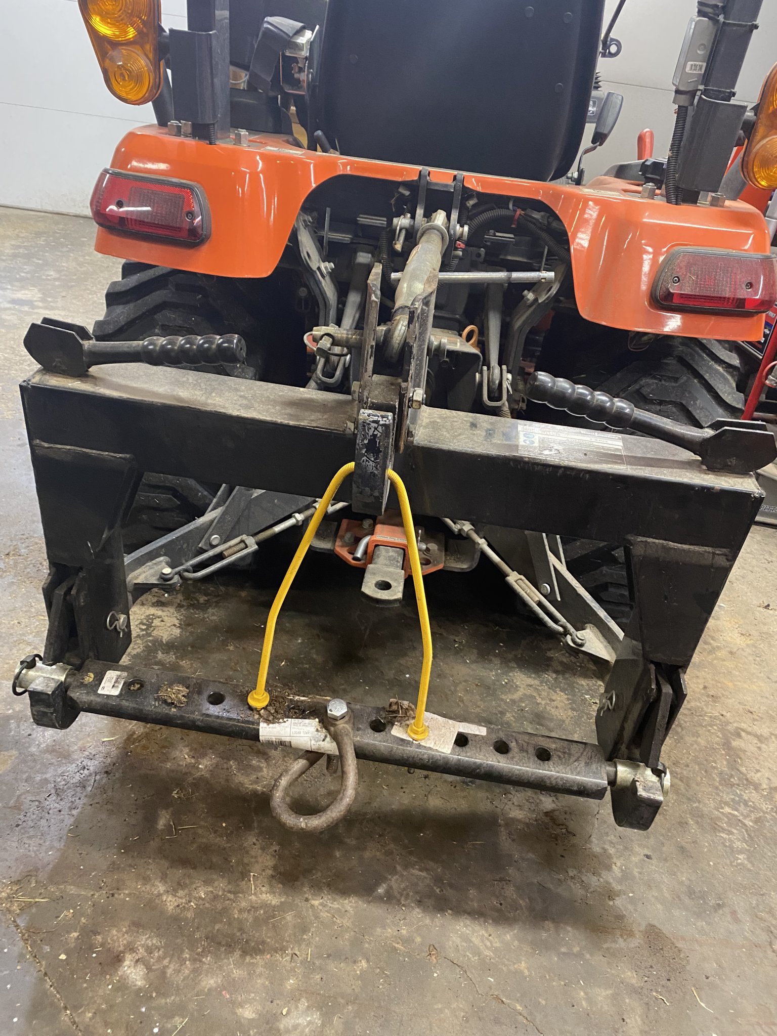

Lower 3 point, loop chain over top hook, lift and drag
9,731
6,351
This is a redneck approach on a little BX. Your tractor is obviously much larger.
A drawbar (Cat 2?) with a simple piece of threaded rod (5/16 or 3/8"?) looped up to top hook. Keeps things from spinning around. Although light, the rod hasn't bent yet.
You could mount a receiver to the drawbar.
My only cautions are (1) lifting the log too high may cause loss of weight on the front of the tractor...possibly flip it over and (2) the 3 point hitch, without any down pressure, the tongue of a trailer can lift the entire 3 PH assembly and possibly try to run you over.
Nice thing is just open the levers, and the whole thing lifts off in 10 seconds. Nothing to disassemble. Maybe could be scaled up to a larger machine.
Could possibly work a shackle on the top hook as well, which gives 2 hook points, but that also increases the risk associated with raising the log, etc.
You can see I also have a receiver hitch down low. Lessens risk of both issues above. A BX doesn't come with a functional drawbar for that purpose. That receiver and drawbar are aftermarket.

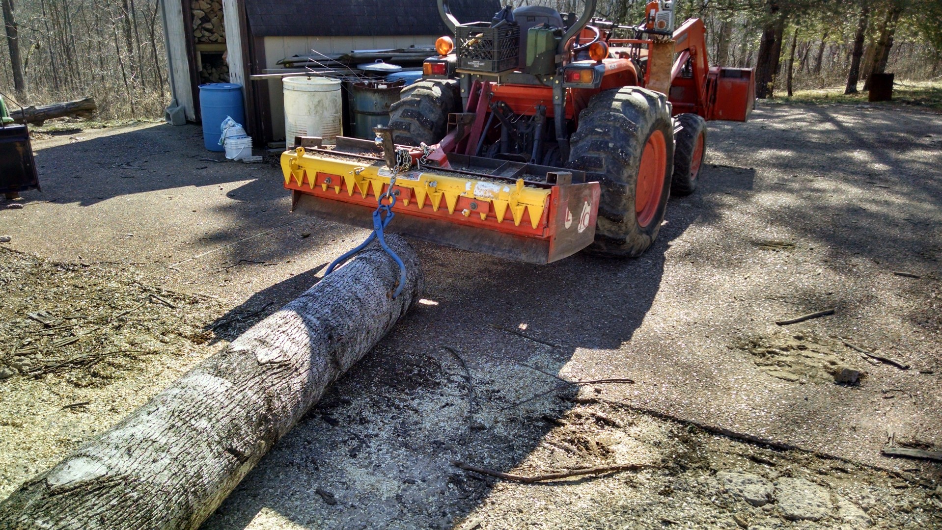

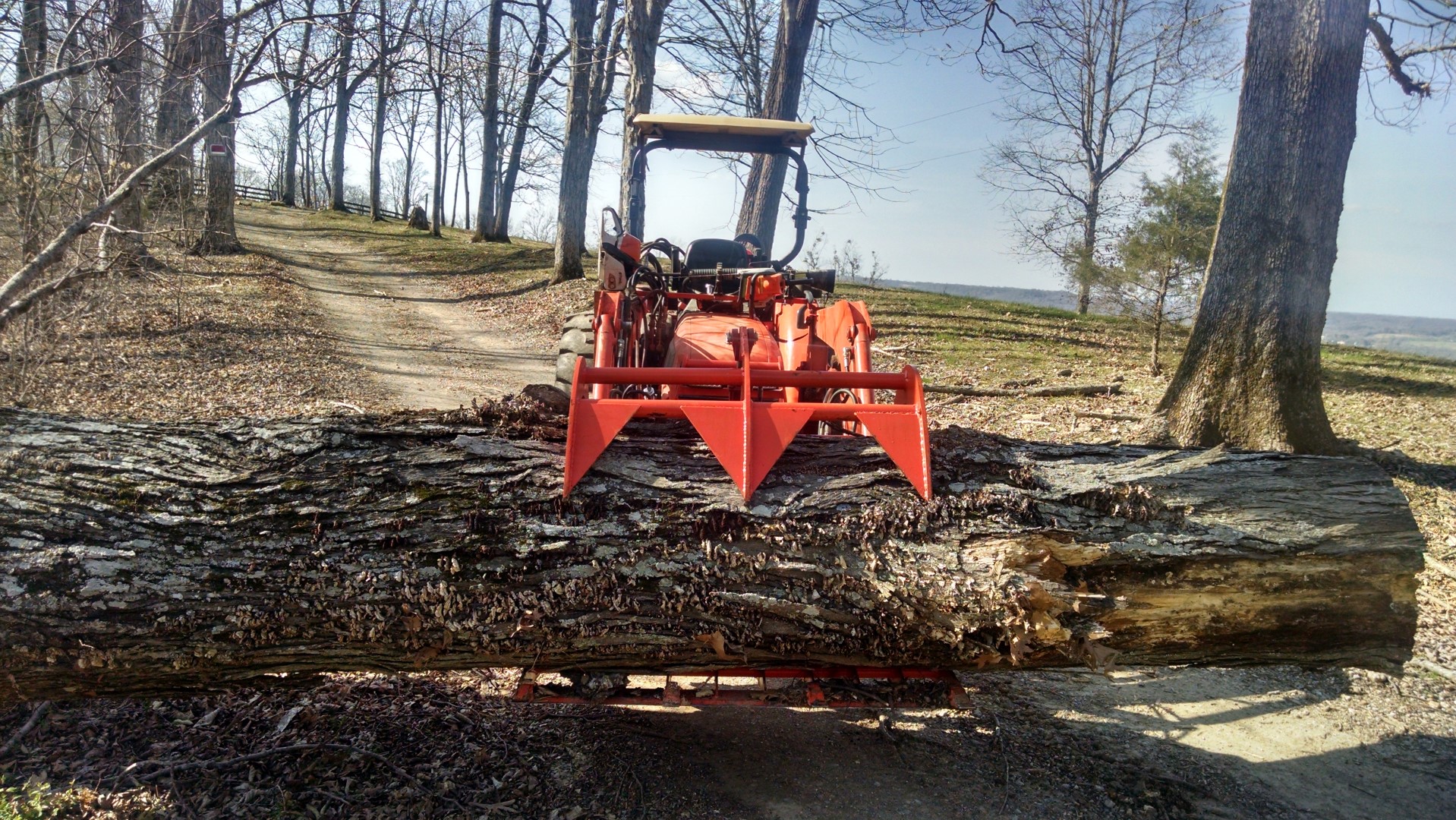

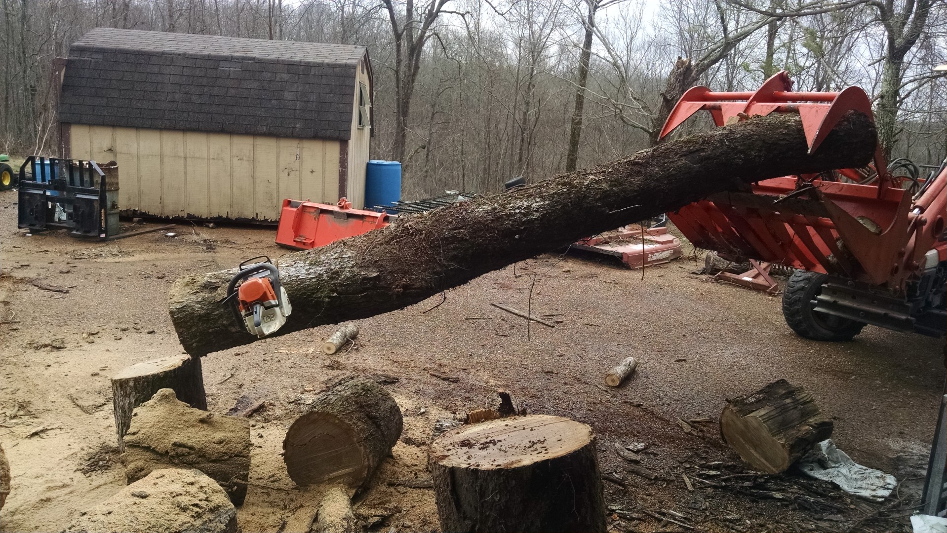

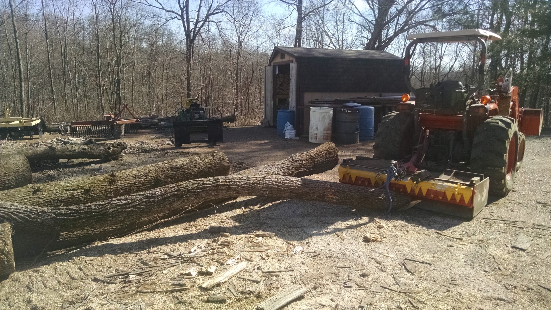

Used to do that with a hitch, chain and a Logrite log tongs. Then I got a grapple. I've never used the tongs since. Side note: They are the Logrite 28" version (the largest); if anyone wants them, come get it.
Before:
New, mo bettah way:
Plus the added benefit of making bucking logs far more easier and comfortable:
And I'm serious about the logging tongs: I-65 near the AL/TN border; free for the taking.

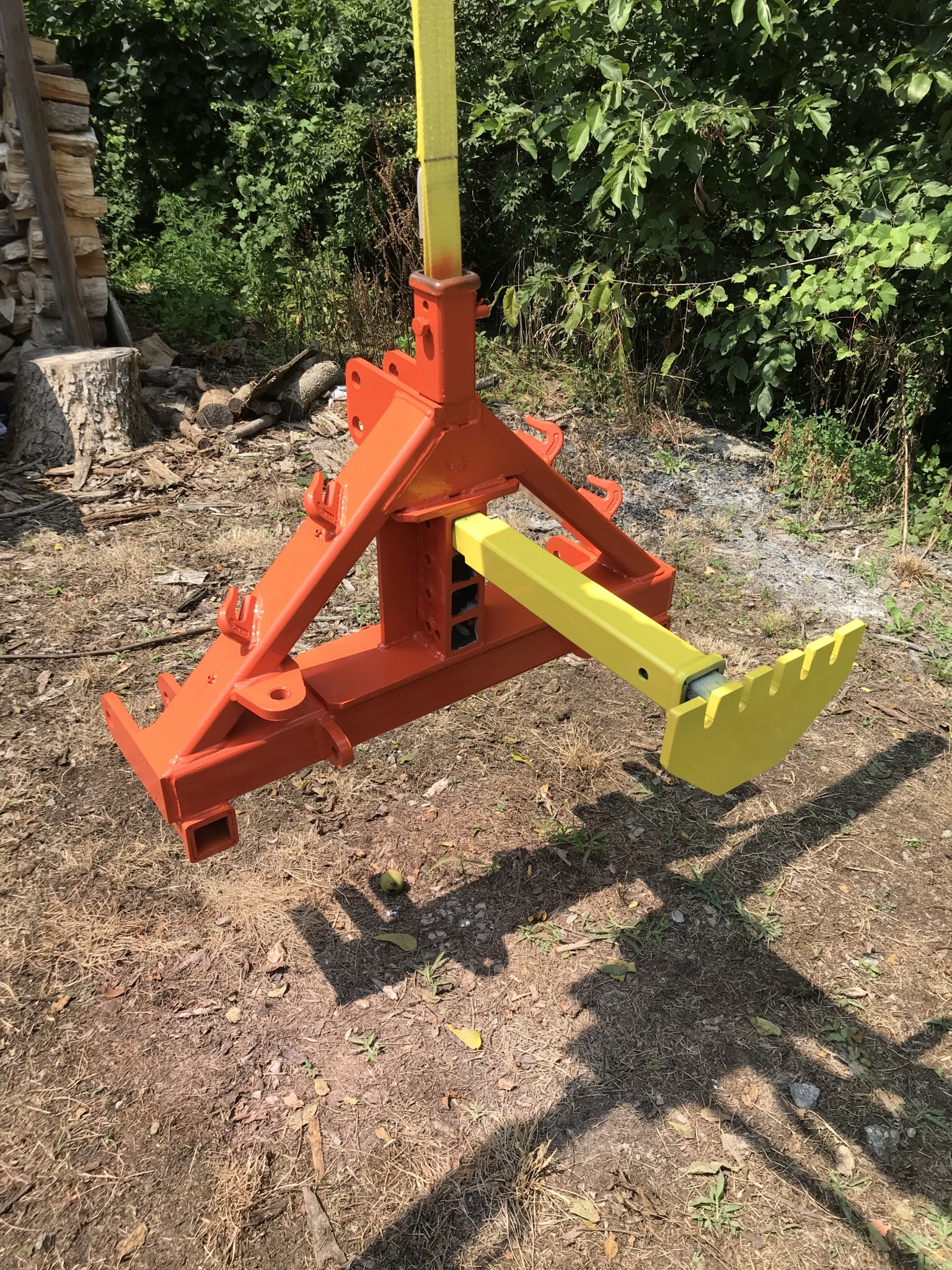

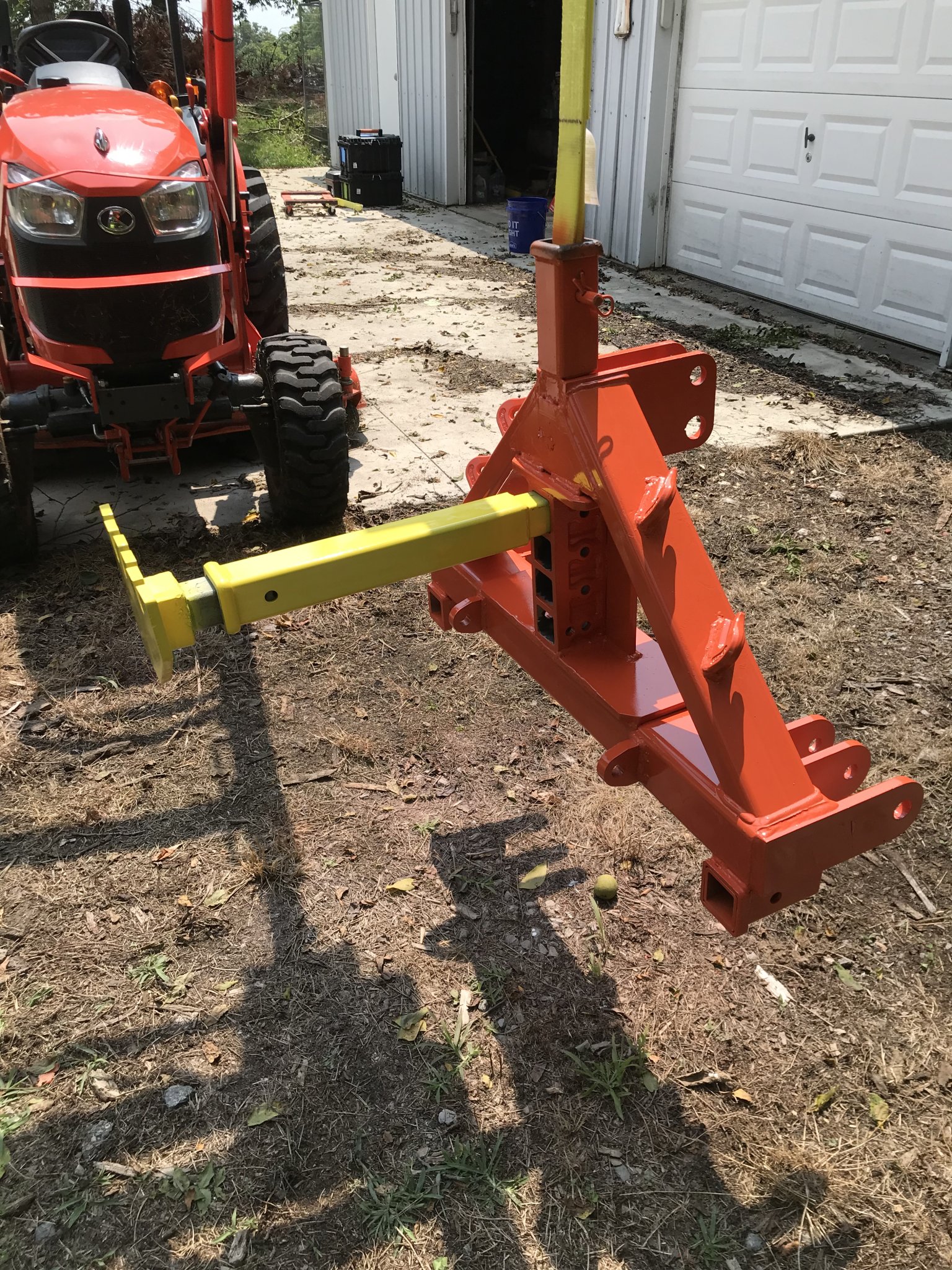

I started with the base part from a back blade and added based on my intended use from there. It’s modular so you can use as a hitch or put a wood vice in or a box or whatever will slide into a 2 inch hitch. Add some shackl bases for shackles

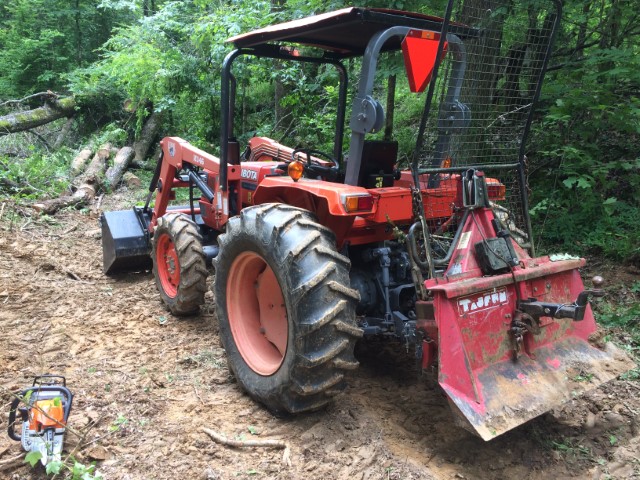

I use a logging winch that connects to the tractor's PTO:
The hitch receiver is removable and of course the hitch can be flipped for lower attachments.
